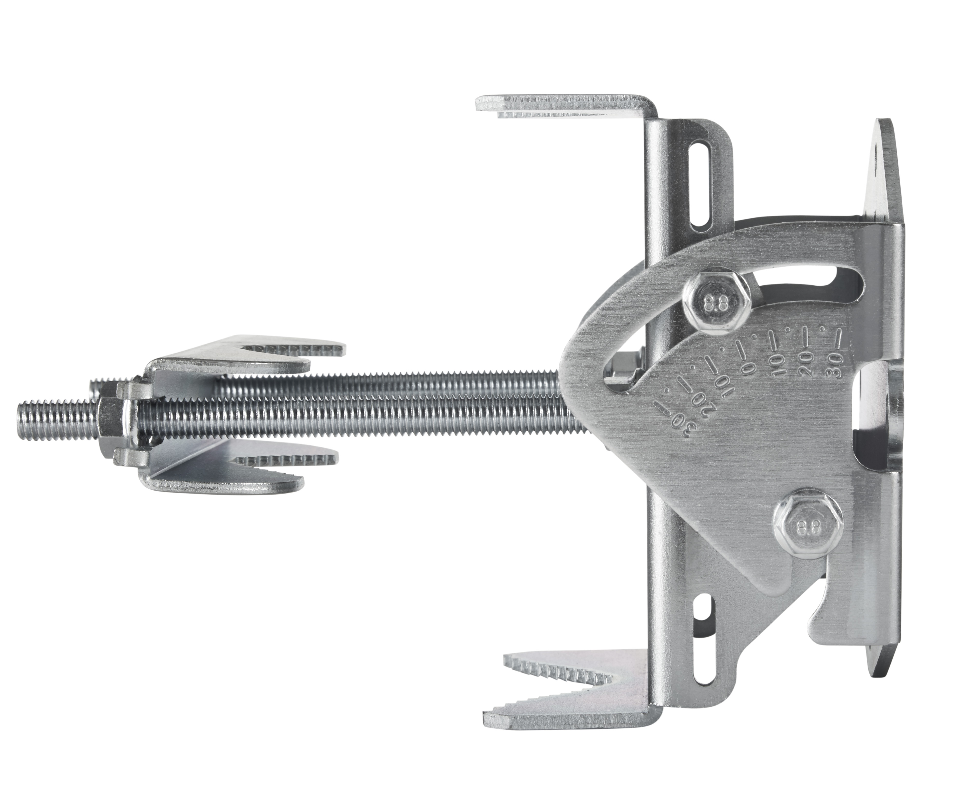

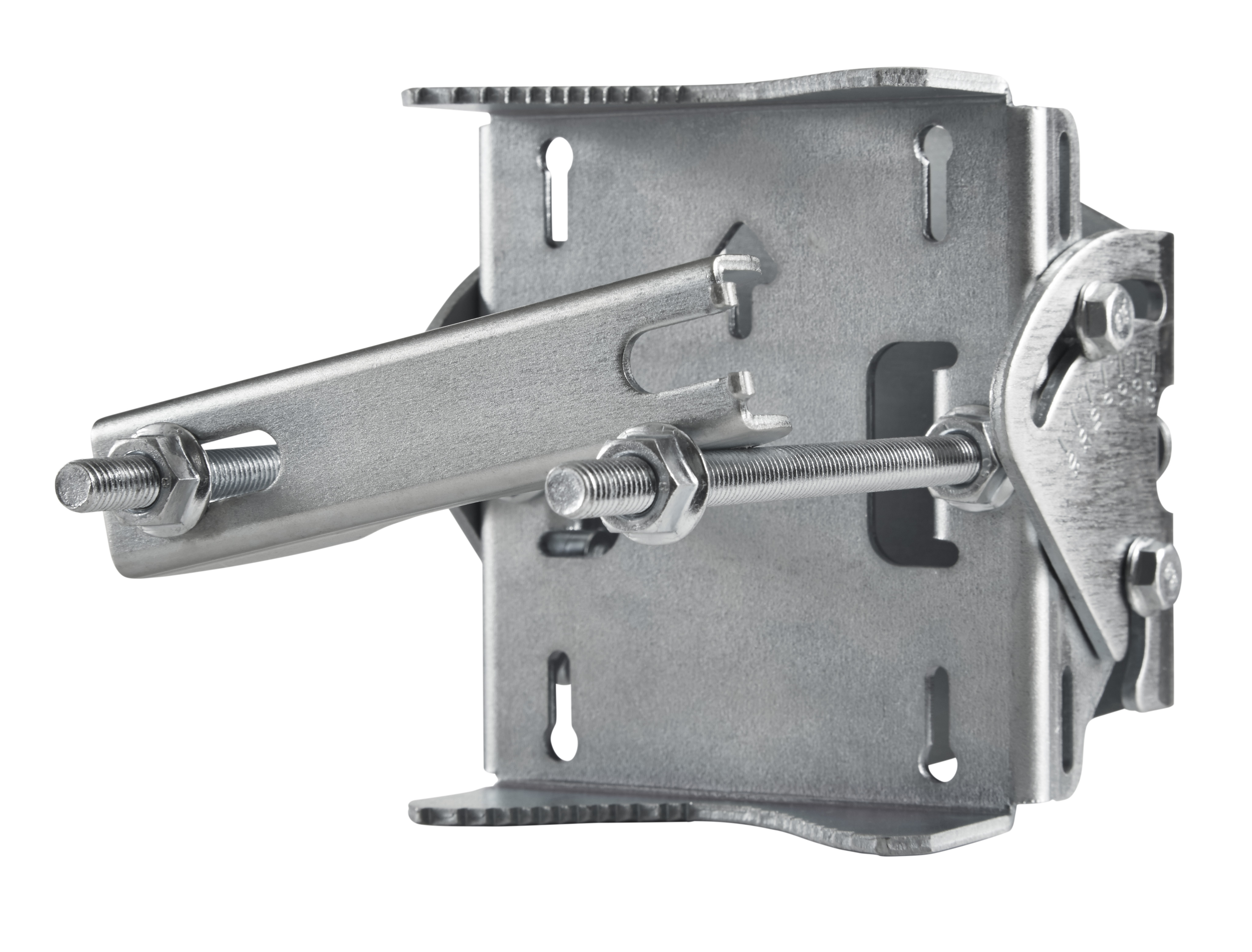

Personally, I would look no further than the $29 MSRP Tilt Bracket that we sell (N000045L002A). It's a great design, and created specifically for this device (I have a "No Drill Gaurantee" if you use these!)

That indeed looks like an excellent mount. I will just say this... I see the ePMP guys did away with the stainless on stainless with the Force200 hardware. You really need to consider doing the same. That's the biggest issue hardware wise that we've had with 450 gear, the stainless on stainless consistently and very inconveniently seizing.
Although the pictures were of the original hardware (which is why they look a bit shiny), this tilt bracket and all hardware utilizes a dacromet finish (corrosion resistant process). You'll notice a bit more of a matte finish when receiving these now.
There is nowhere where there is stainless on stainless anymore. We have been listening.
