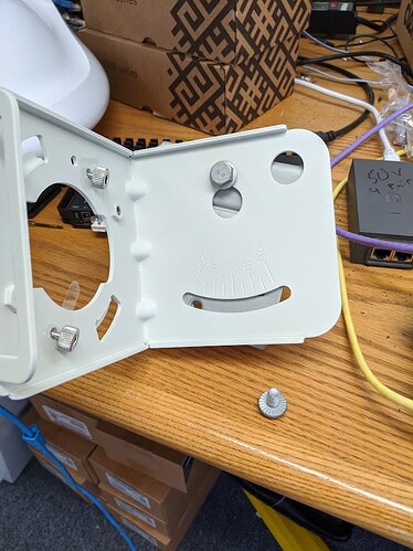

Complete tangent, Do those radios actually come with Hose Clamps for mounting, or was that by choice? I’m firmly in camp “U-Bolt” so just curious.
Unfortunately… Yes. Hose clamps.
Wow, color me underwhelmed with that…
Over the years, I have always had to buy good quality hose clamps from the hardware store. The ones provided with other radios didn’t allow for them to be properly tightened. Hopefully these are better.
The unit can be modified to use the (far superior) bracket from the 450b or force 200 dish with a bit of grinding. As you can see in the photo here, it is only a few mm off. If you grind out the upper hole (with the bolt in it in the picture), you can make it work.
Ah yes, I am familiar with grinding down the tabs on the force dishes. Had many installs that needed to change the orientation of the radio, and without modification the ports would have been facing upright. Started grinding down stacks of them and giving each of our guys 3-5 to have in the truck. Just always chalked it up to engineer oversight.
Finally found a bracket I ground the tabs off of to change dish orientation. On the force 200’s I was comfortable doing this because they still attached with bolts. Worked very well.
Could anyone post a pic of a 4600 SM mounting bracket?
4625 and 4525 bracket is the same:
If like me, you don’t like the hose clamp mechanism - grind out the bracket a small bit (marked in black sharpie) and you can use the clamp from the 450b, Force 200, Force 425. I would love it if cambium would re-design the 4525/4625 bracket to use the same clamp as all of the other radios.

And so you are stuck with that orientation with original mounting system are you not?

The one saving grace of the 4525 and 4625 bracket is that you can flip the feed horn easily and have the bracket on either left or right side without further modification.
