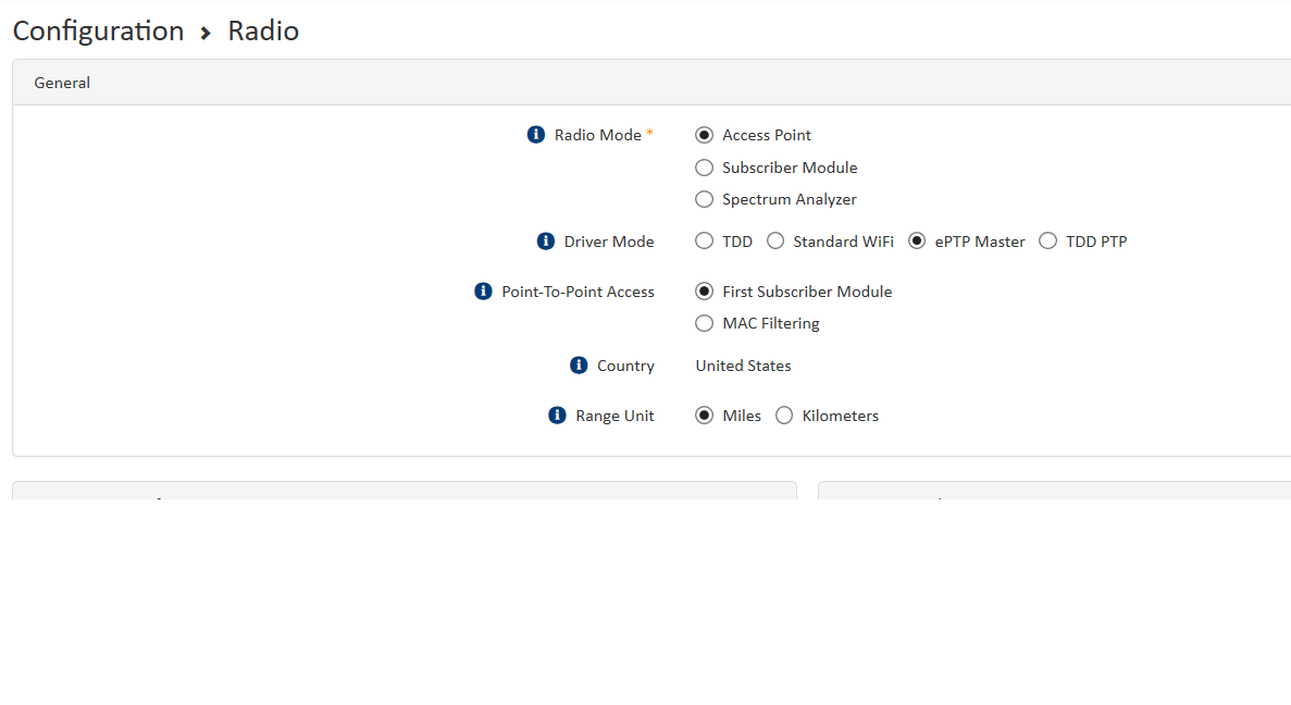

Is the ePMP master configured as  TDD, WiFi, ePTP or  TDD PTP

THey are setup as ePTP
I don't have ePTP on any of my PTP radios so I'm not sure what the options are on the client when in that mode. So on the Client radio, under the Configure > Network section, is there an option for NAT / bridge / router ? Is it set to bridge ?  If not, I would think you would want it bridged.

I use TDD PTP but we have to have GPS sync to prevent self interference, ePTP has a little less latency I believe so I think it is preferred by most people that don't require GPS sync.   In ePTP I assume the CLIENT radio still has the option of being configured as router or bridge.

I will give it a try today, I switched back to TDD. It is possible the SM is backwards with the master
I finally had a chance to go back and work on this. Or I was more forced to go back and work on this when the device has stopped communicating on 40 megahertz. They were backwards and after resolving the issue and adding 20 megahertz band everything works great. Thank you
