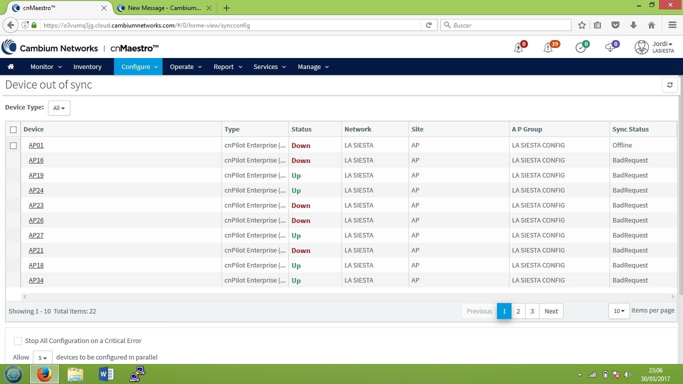

I have 50 AP in same group config it have auto sync, but only autosync in 20 devices others imposible to sync,
if online conected to cloud, try to sync manual and it is impsible says BadRequest, i contact to camibum and no give solution it isn't seriously,
its E500 firmware all 3.2.1-r6
Can you navigate to Configure -> Configure Devices -> Jobs, click Show More on the latest job and send a screenshot?  This should give you more details on the failure reason.  The Created by field for the job will say somethink like Auto-Sync.
Yes, thanks, i try to force sync and says bad request.
Thank you for the screenshot.  Can you scroll to the top of that page, click the Jobs tab and then click the Show Devices link for the latest job with failures.  A screenshot of that will be helpful for determining the cause of the failure.
If that doesn't give us more info we can walk through getting debug logs directly from a failing device.
Shows time outs but Ap is Up and conected to cambium
