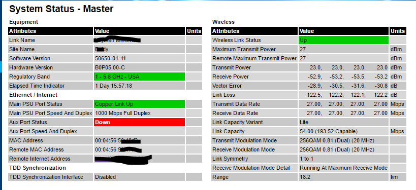

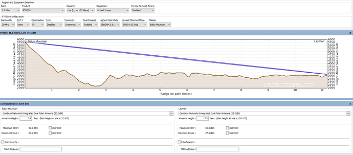

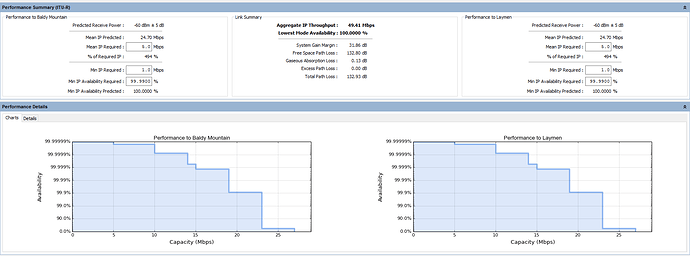

I'm assuming that this link is successfully installed and aligned with a line of sight path, as shown in the LINKPlanner project. The Link Loss (122 dB) reported by the PTP 650 doesn't quite make sense. A line of sight link at 5.8 GHz and 11.2 miles has a loss of 133 dB. It's possible that you have used larger antennas, and not updated the antenna gain on the PTP 650s. Could you check?
The ODU is transmitting and receiving at the top modulation mode of 256QAM 0.81 Dual. The reported capacity is correct for this modulation mode, 20 MHz bandwidth and the Lite license.
