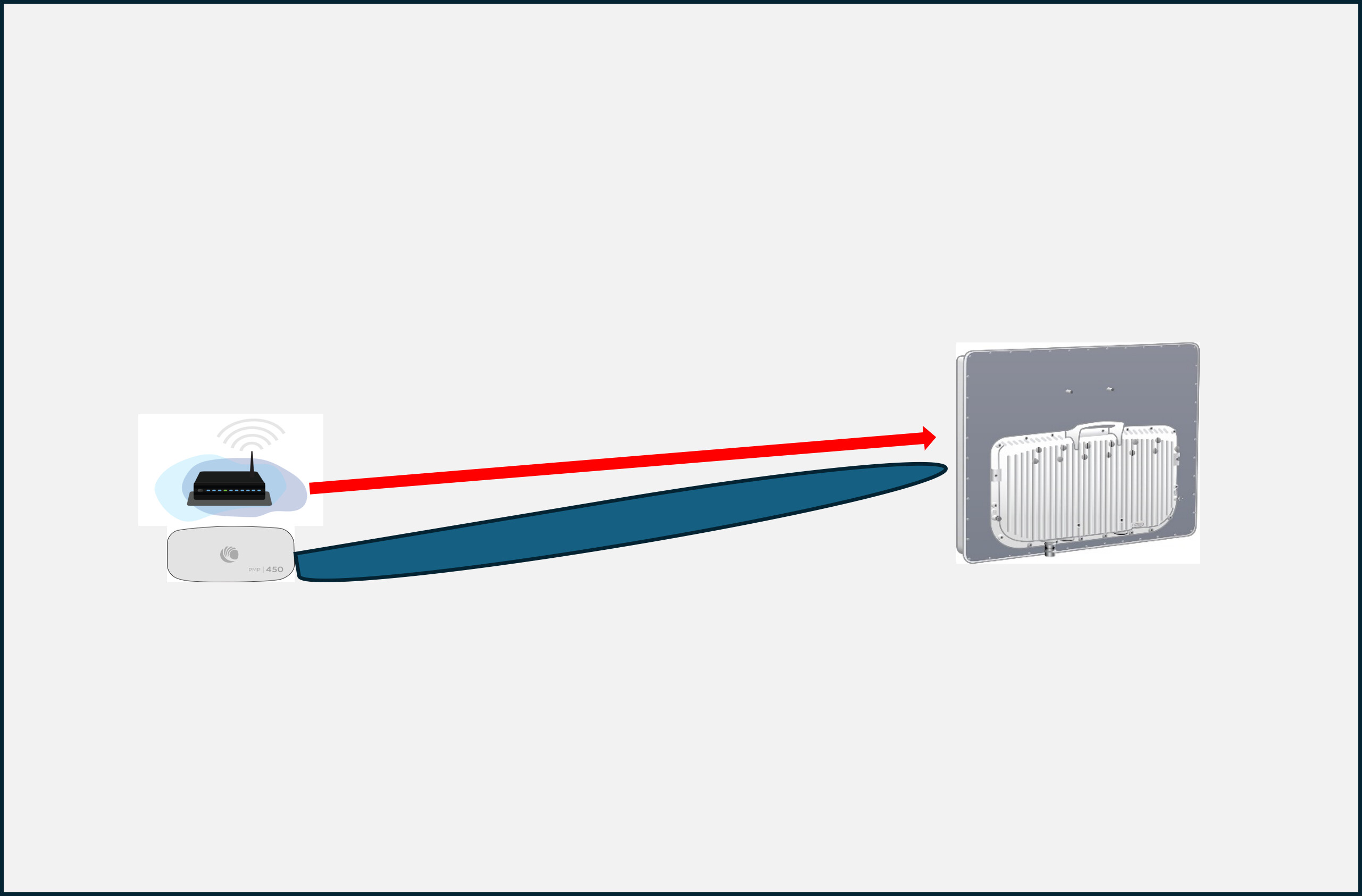

PMP 450 Interference mitigation
Some WISPs have had the opportunity to test out the latest interference mitigation techniques, including beam steering, digital beamforming, and data refinement.
Share your results and experiences with the new features on this thread.

“Typically” is a challenge in this case… benefit will only be seen if the radio is actually experiencing interference. So, results vary widely and are really specific to the conditions under which the sector is operating.
That said, we have talked with many customers that are experiencing great results and improved subscriber experiences (i.e. higher modulation rates and improvements in total uplink throughput) on sectors where they were suffering interference and have enabled this feature. I again invite anyone to post their experiences with using this feature here in this thread.
