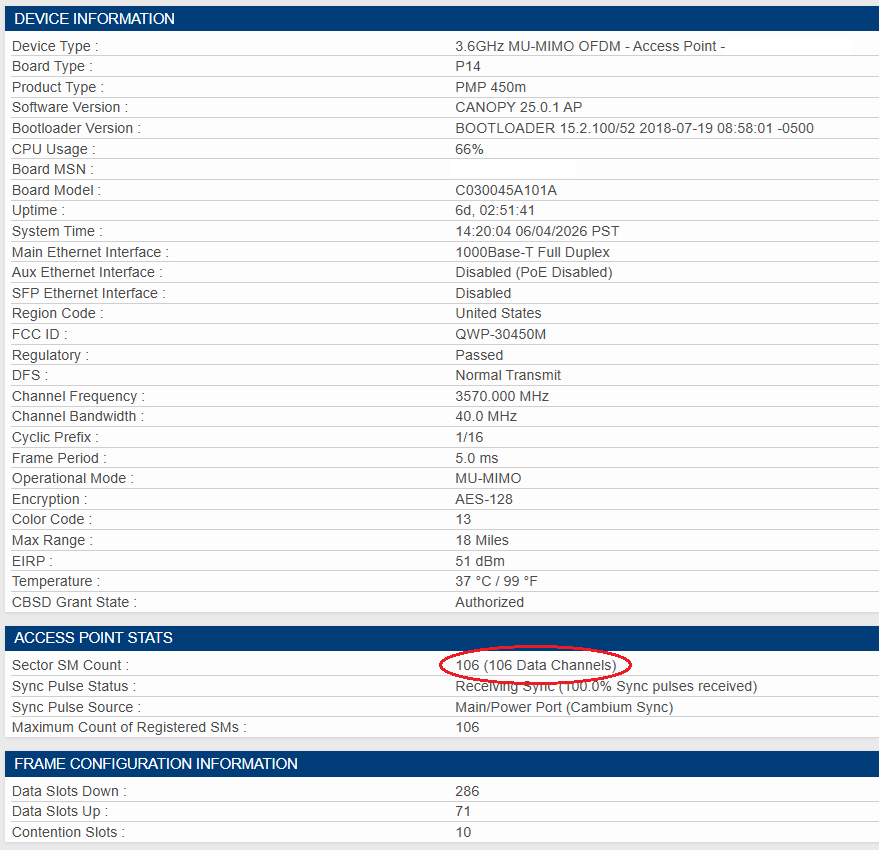

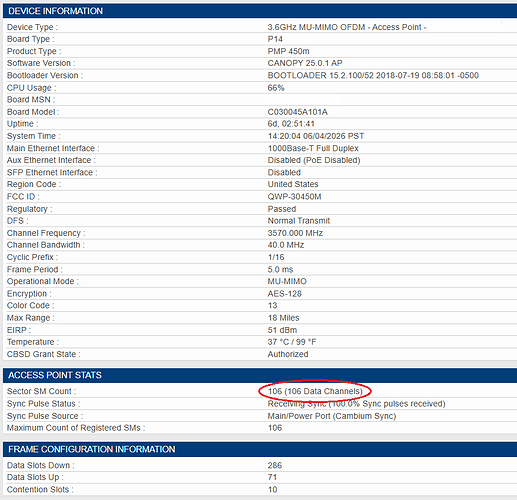

any thoughts on growing more subs once we firmware upgrade and tweak the other items?
Assuming that there’s spectrum available, if you can move up to 30 or 40MHz channel width, that will allow you to load up quite a few more SM’s depending on what speed tiers you’re trying to deliver.
We are at 40 Mhz channels now, looks like you are at 106 SMs so that is reassuring
