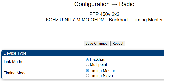

Thank you, this is clear. You’ve applied the key to both radios in the link (if they were both the C060045C200A to start)? If so, then the radio config screen should look like this:
If not, you may want to open a support ticket and our tech support folks can help you.
