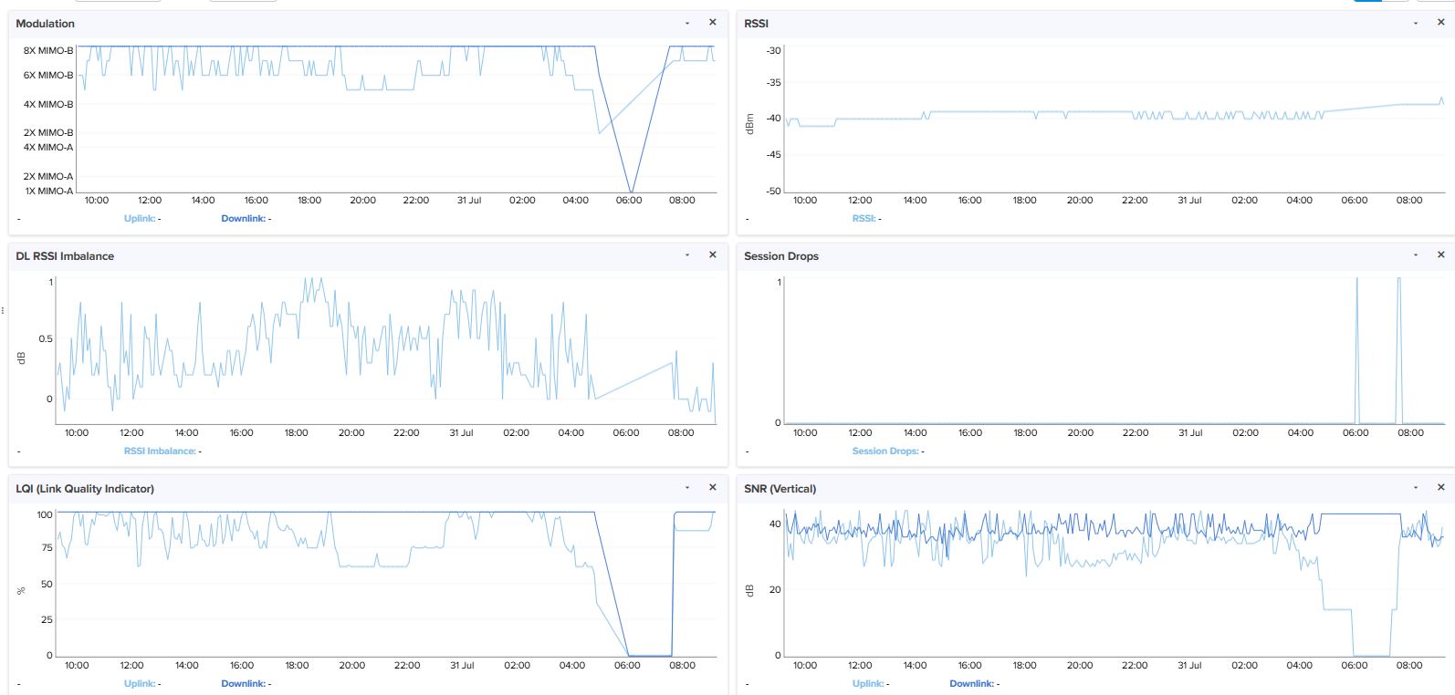

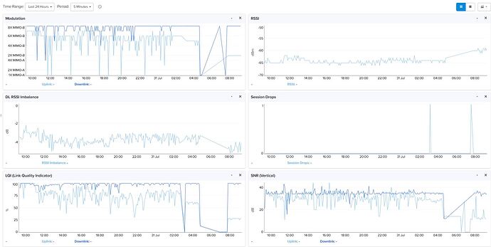

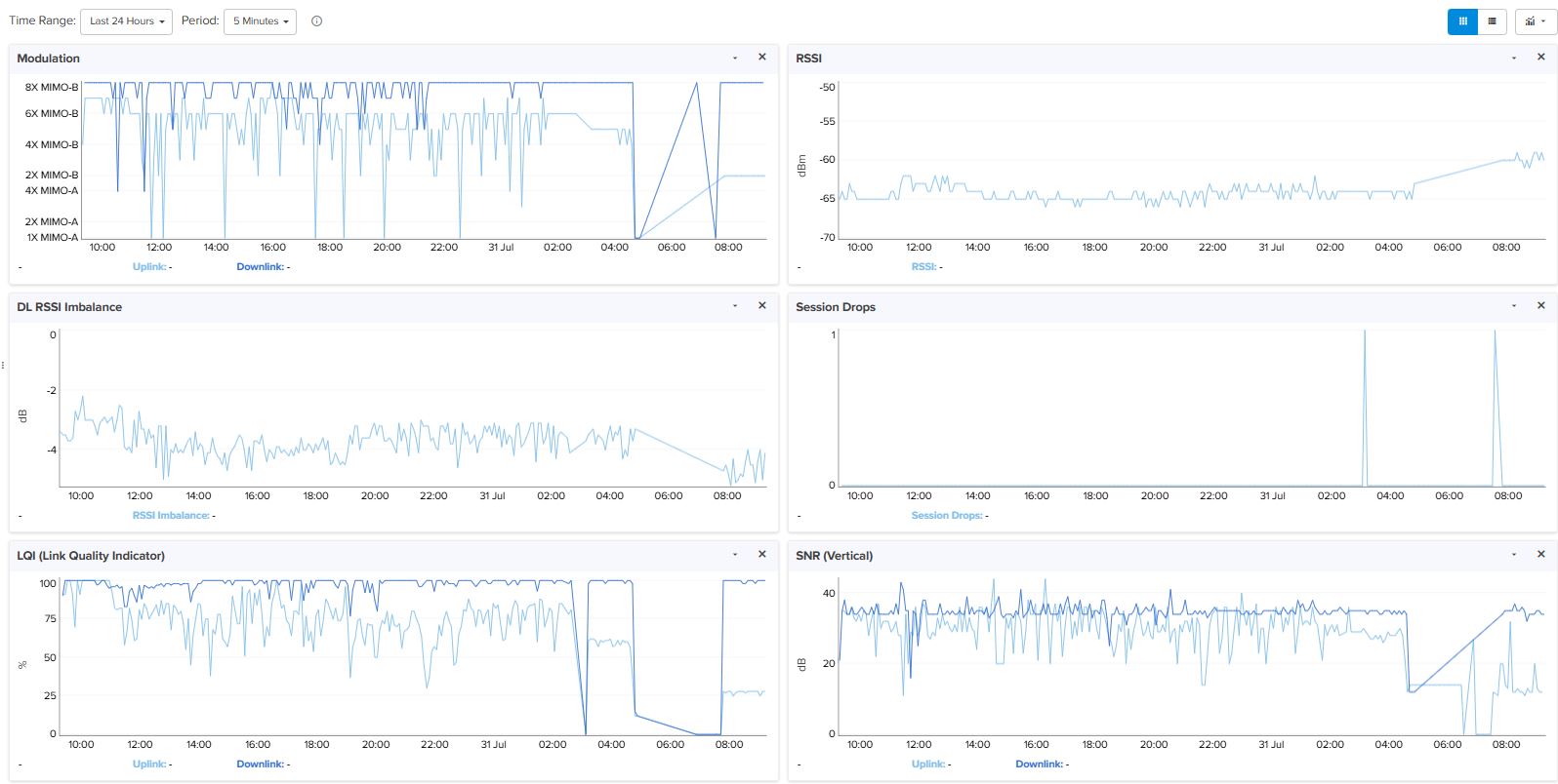

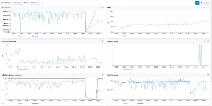

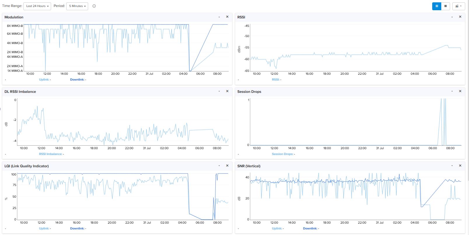

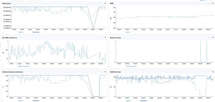

Here’s some of the cnM graphs for some close range customers. Things are just all sorts of whack between the AB channels.
Signal levels in the -40s to -60s in 3ghz shouldn’t really be prone to this type of swing.
These graphs look like interference is causing the SMs to drop offline. Have you looked at the sessions list on the AP when this is happening? I suspect if you can, you will see modulation rates start to drop before the SMs go offline.
I have often seen similar in the past when some SMs on a sector can see an interfering AP while others don’t. The SMs seeing the interfering AP will drop offline, often in sequence and come back at different times. I’m not sure if there is a timing component to the interfering AP vs our AP or not, but usually I’ve seen this where another wisp has a 450m AP in similar azimuth from the SM to our 450i. It “seems” like when the other WISPs customers in the are of ours are busy the problem gets worse.

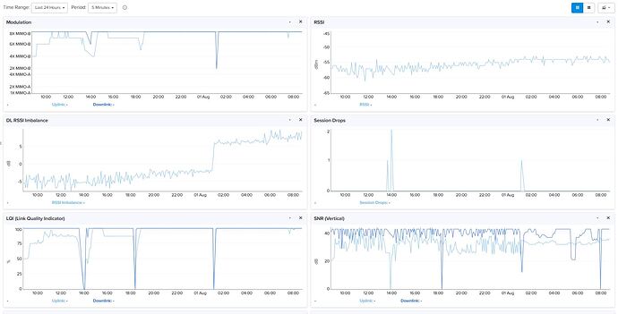

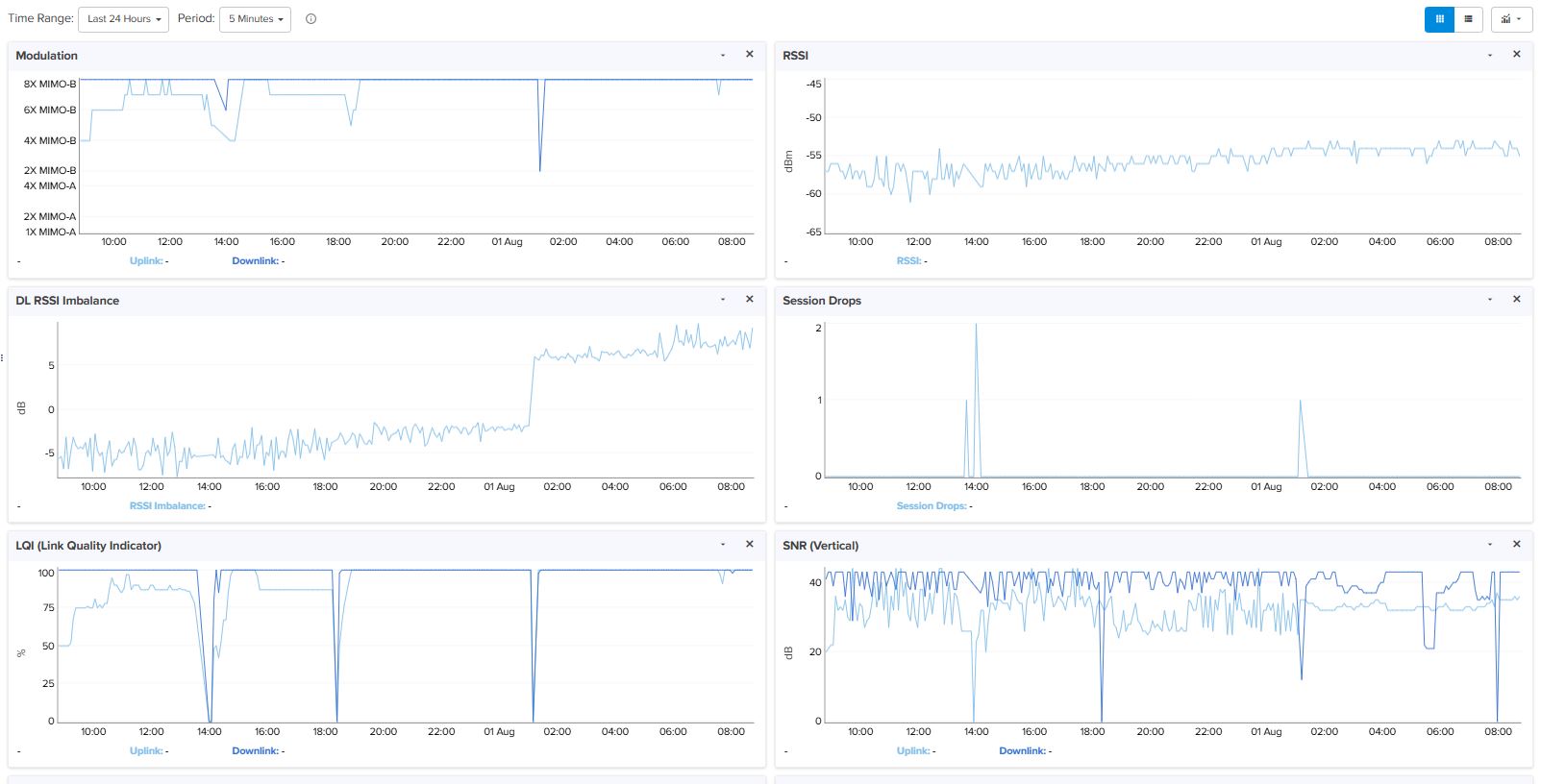

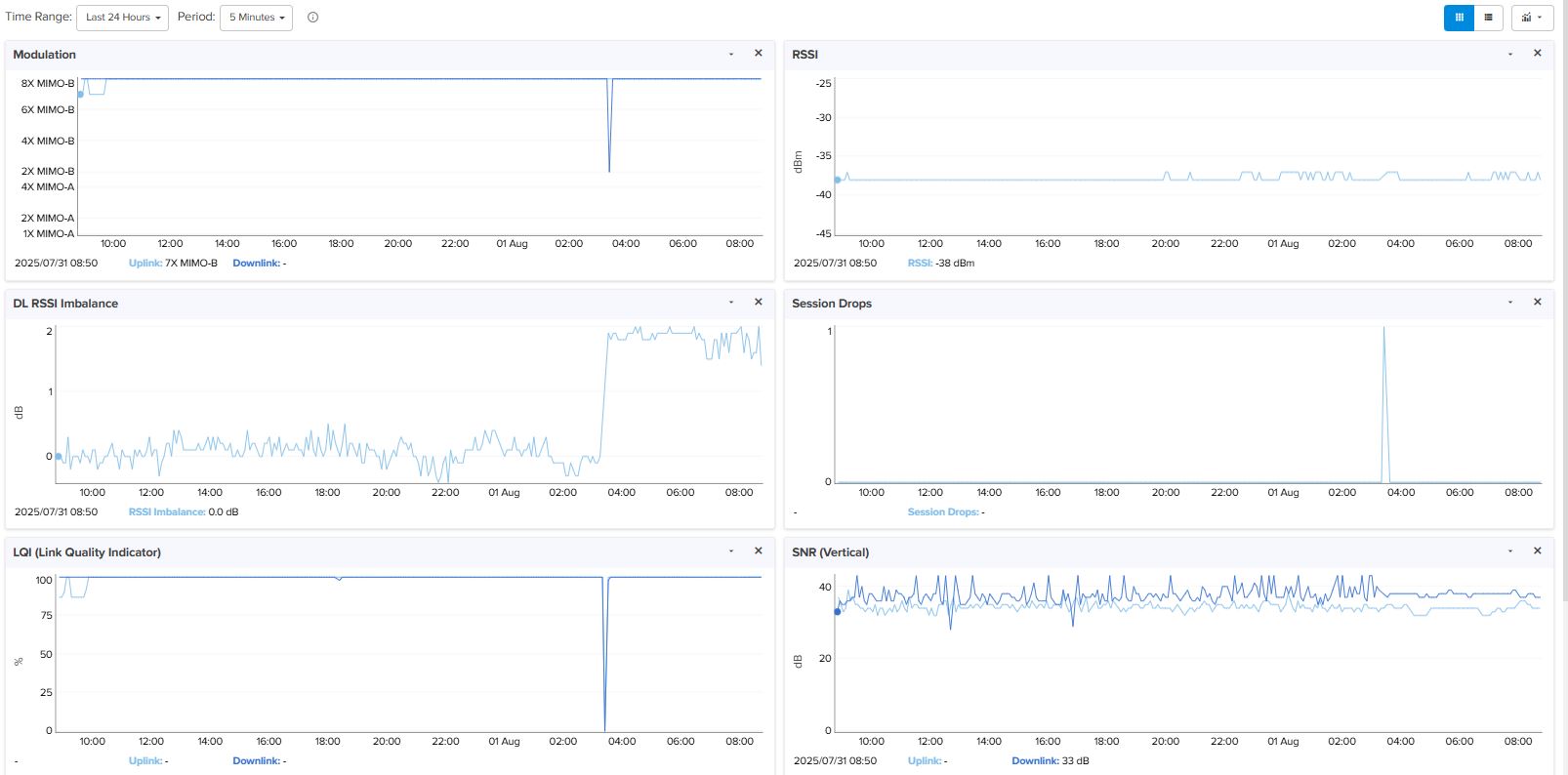

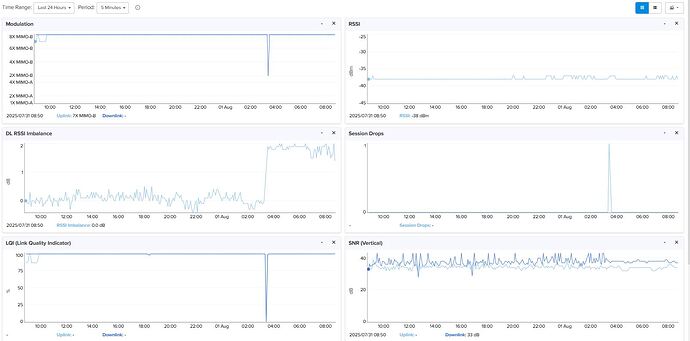

Attached are few graphs that show around 2am when the firmware downgrade took place the changes we have seen.

LTE Colocation settings provided a major improvement in our SNR and RSSI imbalance so big thanks to Eric for pointing us in that direction. These issues appeared to start back in June and have steadily gotten worse over the last couple months.
