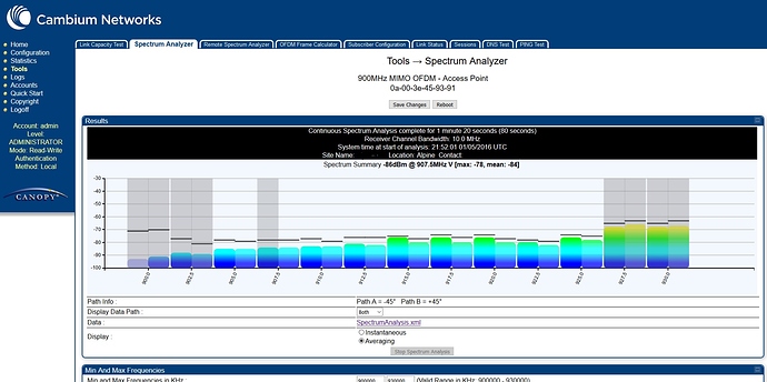

Just wanted to get everyone opinion on the spectrum analyzer accuracy on the PMP450i 900mhz AP. I just recently replace an or Trango 900 AP with the PMP450i and I am currently having issues with high latency on my wireless subs. When I first put it up everything looked good except on the linktest the uplink percentage was around 75% for every sub. I started at 10mhz at 907 and finally had to drop it down to 905 with a 5mhz channel just to get any type of stability. Could the AP perhaps pick up noise that wouldn't appear on the SA?
At first glance, that noise floor looks pretty good for 900! Is the latency/jitter consistant, or is it intermittent to all or just some of the clients? If you look at your frame utilization when latency is high, is your uplink frame utilization being saturated? ALSO, if your client(s) are hitting their max upload MIR, this will cause lots of latency and jitter, and dropped packets.

With the AP noise floor looking the way it does, and the SnR you posted for that client, I'd assume that using a 10MHz channel would be possible. I know this is going to sound strange, but can you try a 7 or 10mhz channel width?

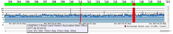

Yeah, I'm not sure what to tell you... I can show you a couple AP's that have way way worse noise then you and our ping times are averaging around 21ms with pretty low jitter. This is our worst connection on an AP with 6 other clients. It's a 7.5mi shot, non-LOS, connected at -69, 15dB SnR, @ 4X-mimo-B. They use VoIP on this connection frequently during business hours with no issue.
Oh an we're running a 7MHz channel width, and 2.5ms frame size.. ALSO... what firmware are you running? I'm using 15.1.
OH yeah... dunno if you tried this, but if you're using 5ms frames, switch to 2.5ms frames to reduce your latency... of course this has the opposite effect of lowering overall throughput by about 10%.
PS. don't mind the red... those are scheduled downtime blips.
I have 15.1 on the AP and 15.1 on most CPE except for 3. Working on getting them updated as well, but so far not having much luck finding a channel that will work. I do notice clients connection quicker when I drop down to 2.5ms. From my testing it looks like there is interference around 907mhz even though the SA doesn't show it. Its too bad I was really hoping to get results like you posted with this gear. I'll continue to tweak the wireless and see what else I can do to improve performance.
One thing that might be happening is very narrow band interference that the spectrum analyzer in the 450i cannot resolve (i.e. 12.5 KHz energy), or even frequency hopping equipment.
To uncover this, you might try a longer spectrum scan (like 30m or an hour), although it might still not show anything.
