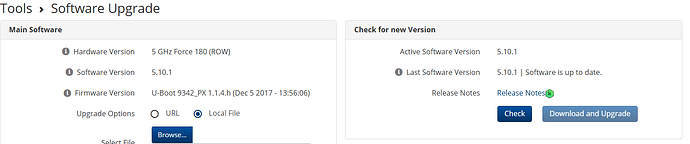

But I am getting the Error the error is (Not compatible software).

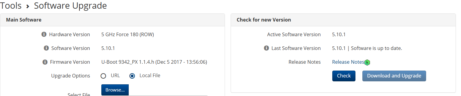

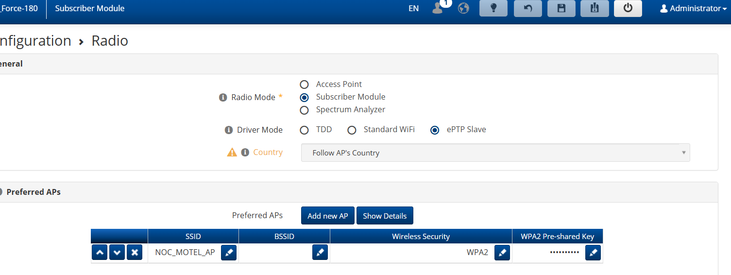

Are both radios using firmware 5.10.x? Have you tried resetting both radios to factory defaults and reconfiguring using the quick configuration tool? Are you trying to use ePTP mode? I don’t believe that you can use ePTP mode between different versions of ePMP radios. Try using TDD-PTP mode.

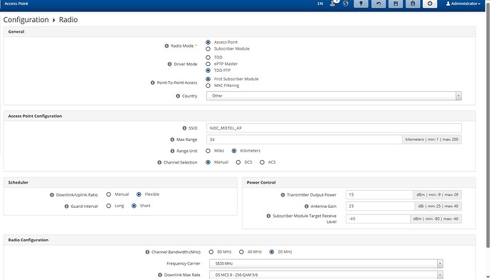

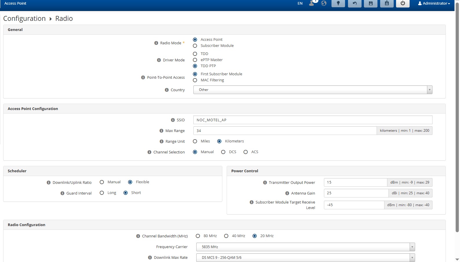

Please try making the F300 the access point TDD-PTP master, and the F180 the slave. If that doesn’t work, then I’m not sure what else to try.

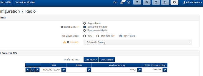

Set the F180 to be TDD.

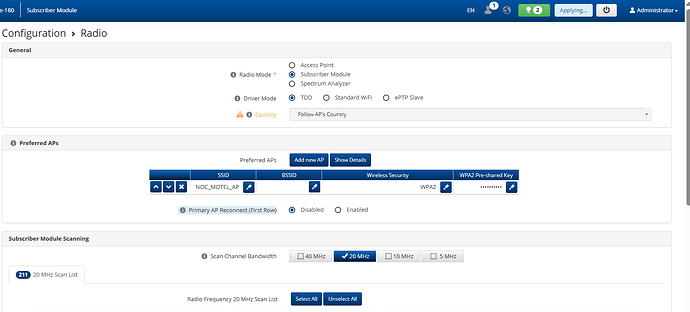

Force 180 i have configured as a subscriber TDD Mode. but device cannnot register.
I guess they don’t work together… try using a pair of the same model ePMP radios for your PtP link.

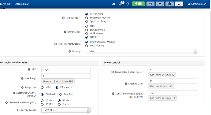

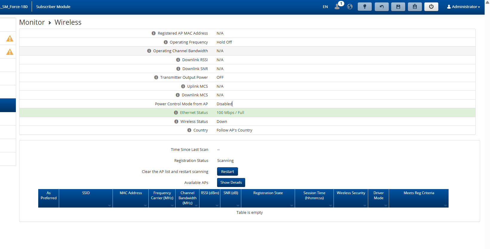

@BUDDHADEV_MAITY SM may be toasted. To confirm this swap roles. Put F180 in AP mode and F300 in slave. If F300 does not see it in scan list or on spectrum analyzer it may be broken.

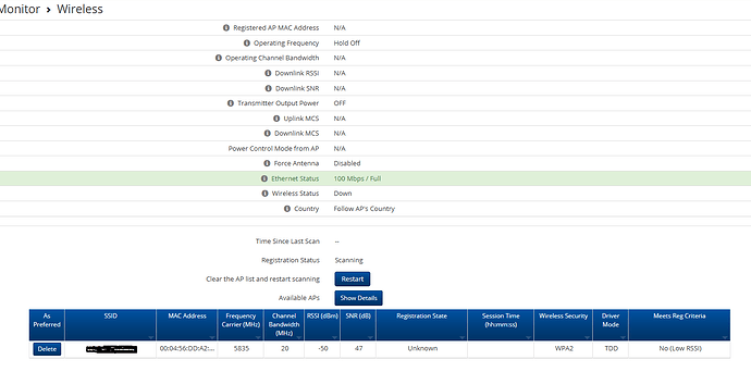

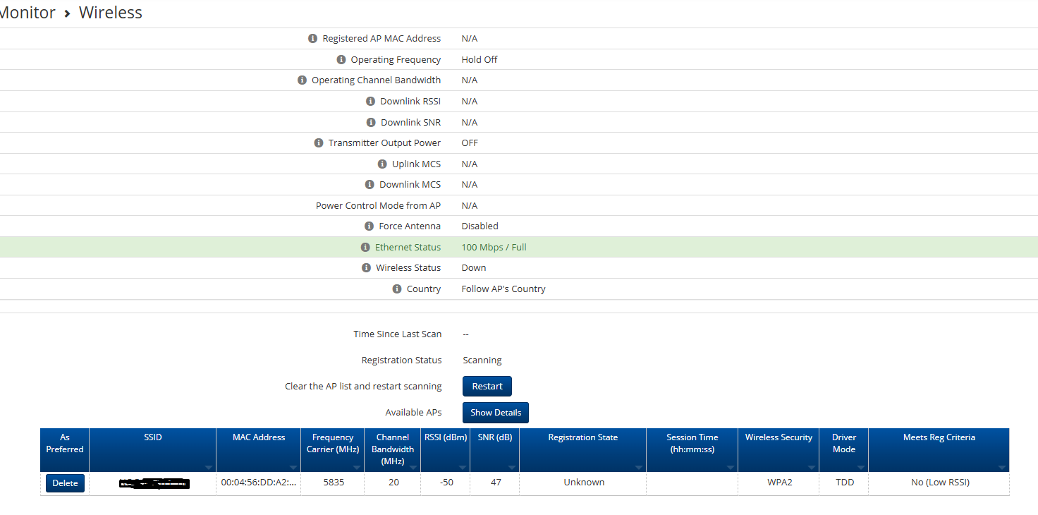

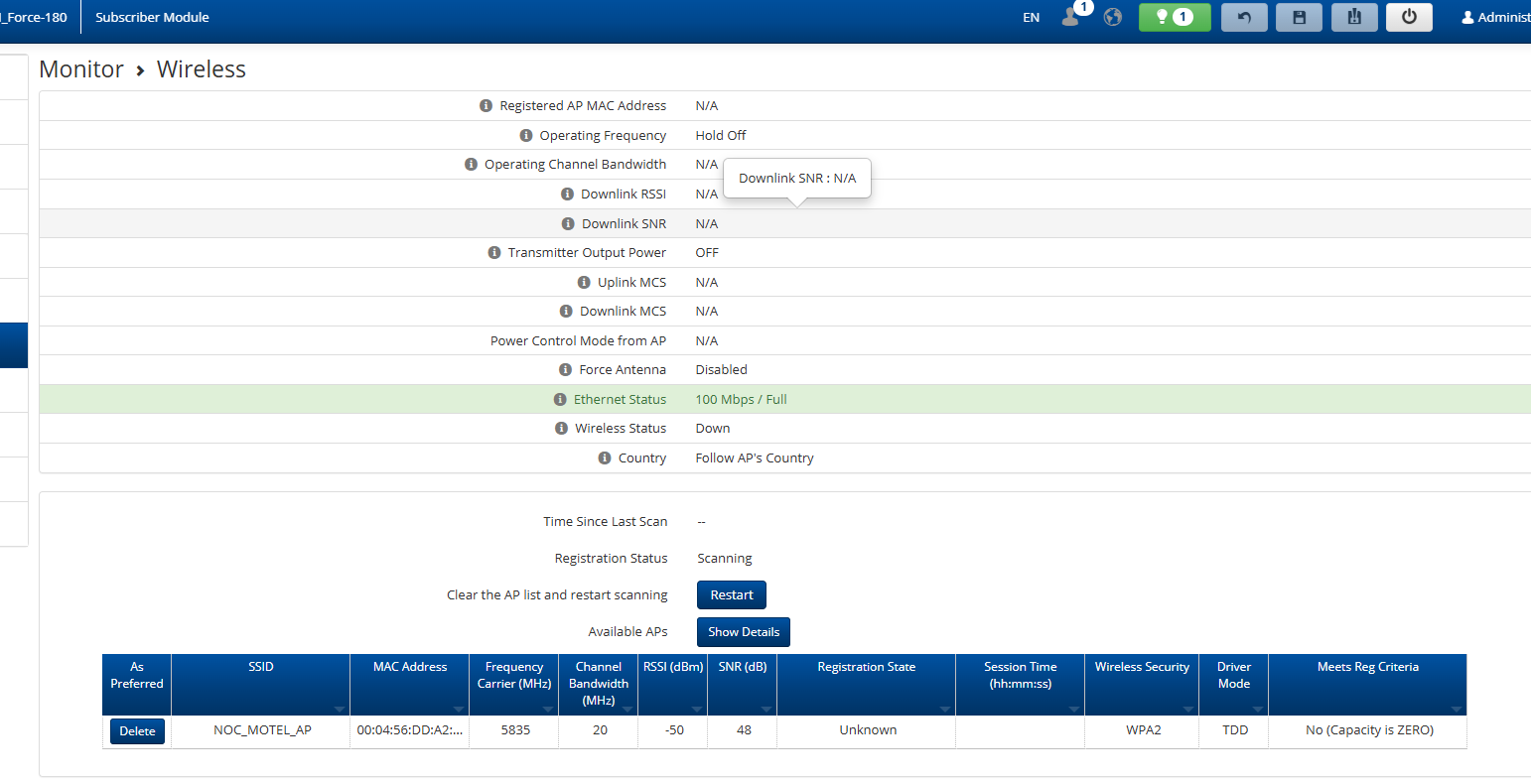

Your SM is also reporting for ‘Meets Registration Criteria’ that “No (Capacity is Zero)”
So, make sure on the unit you have configured as an AP, make sure that the “Max Registrations Allowed” is set as high as it allows (10 or 12 or whatever) while you are testing. So, even if you’re only trying to connect one SM, I would still have it set to its maximum number for testing.
Screenshot_20251022_091523_Chrome
The Reg Criteria message you are getting (No - Capacity is Zero) indicates that It thinks it is at its maximum registration limit, and doesn’t want to accept an additional connection.
I noticed that too… but the screen shots he posted show that he’s using TDD-PTP mode, which should always allow for 1 SM to connect. I guess as a last ditch effort he could try TDD PtMP mode and see if increasing the max registrations allow it to connect.
