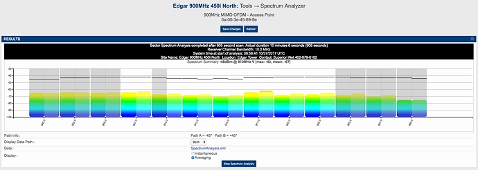

I ran spectrum analysis on APs early this morning. The scans were done concurrently. Here are the results:
Edgar North
Edgar East:
Edgar South:
Edgar West:

What I'm seeing is that you have low SNR in the uplink direction, and relatively high noise floor perceived by the APs.  They're seeing something whether it's a competitor, other of your towers, or meter-reading gear I couldn't say.  What sort of downtilt do you have on the AP sector antennas?

If vertical and the AP is not down in a valley then it's basically aiming at the horizon, able to see any other 900MHz band transmitters between it and the horizon.
Since you mostly seem to be seeing interference at the APs, (assumption based on the distant SM seeing clearer spectrum than APs - the nearer SMs are of course stronger since they're all seeing the tower's APs strongly) it suggests that their height and/or the fact that they're aimed at the horizon is allowing them to see interference sources the clients cannot.  Which is why I asked about downtilt.  (I encourage our guys to apply about 6 degrees downtilt and tweak from there if needed - with a 23 degree vertical coverage on the Cambium 900mhz sector antennas that's enough to significantly reduce interfering signals from neighboring towers and their client bases, though it's no help at all against the water meters that interfere with us in one county - maybe even makes it worse)
