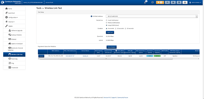

here is linktest result using frequency 5950 20Mhz channel

I mean how much link should I expect on getting, on a distance 3.5Km, while both using 25dbi antenna ? If you take a look at google maps by the coordinates, the area is relatively flat with no houses or obstraction whatsoever

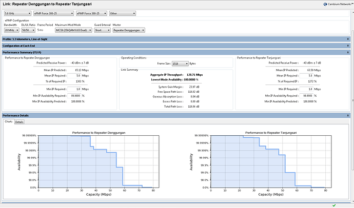

this is what linkplanner says how much the link I should be getting, without interference options selected
and this is with interference options selected on both points
we installed it on triangle tower 20meters above ground in each point
in linkplanner, your link shows the graph which also has a details tab, use this to determine your gain margins, which look a little shy for your link. The best you can expect is DS1.
I am not familiar with the regulations that you are under, but the 24db dishes are not enough for your link with the restrictions that LinkPlanner has. You would need 32db 3ft dishes on each end according to linkplanner to have a good link and if you can get higher gain dishes (KP Performance has some nice high gain 3ft dishes but may not be allowed in your area, but gives you something to compare to) then you could max our the MCS on this link.
