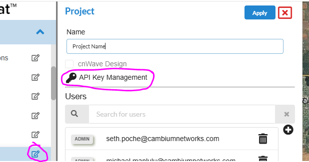

One thing you will need to know. To access our documentation and to generate API keys, click the pencil/notepad icon next to your project name. And then click on the API Key Management button.
