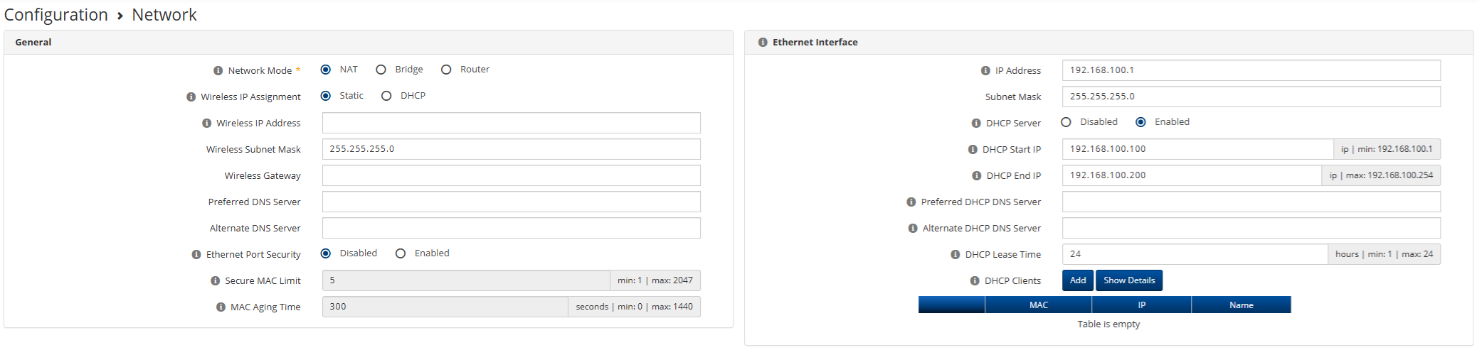

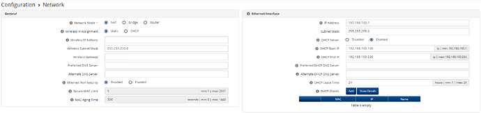

All of our ePMP Force 180 units configured in NAT Mode stop assigning an IP address to the router connected behind the SM.
The behavior is consistent across multiple installations:
  • SM model: Force 180
  • Firmware: 5.12.0
  • Operating mode: NAT
  • WAN link is established correctly.
  • The DHCP server on the SM no longer provides an IP address to the downstream router connected to the Ethernet port.
As a result, the customer router never receives a DHCP lease and remains without connectivity.
Rolling back to the previous firmware restores normal operation, so the issue appears to be specific to v5.12.0.
