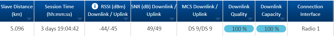

Hi all, I have a 5km link that pushed a lot more bandwidth when I first set it up and I am not sure why… software changes? Here are some stats from the master and slave…
Master:
Slave:
master:
Running 4.5.4
Getting 254mbps DL and 69mbps UL 323mbps aggregate
I have 2 other links, one is a 25km link and the other is 32km… they are getting 220mbps… so I was curious my 5km link isnt getting more bandwidth?

If you do a path analysis in linkplanner do the signal numbers match up? I always start with a baseline and make sure I am getting the signal I am supposed to. By looking at your numbers I would say you are spot on, but I would want a sanity check before I went further.

Hi, thank you for your reply… yes they do match up with link planner but in link planner I added some frequency interference… but as you can see by my stats I have little interference. When we first launched this link I was getting 330mbps down and 80mbps up, 40mhz channel, only thing has changed is firmware… original firmware was 4.4.3… I was considering rolling back… only reason to upgrade firmware was to use eptp, which was and is a complete disappoint.

@Olympe, Thank you for your response! As per my screen shots I cannot see this being a frequency issue. But I am open to correction.

I believe he said he is running TDD with 75%/25% ratio - so more DL than UP capacity would be expected in TDD mode.
@ninedd @Olympe
Correct I am using 75/25 TDD PtP
I know we all are running after interference is the issue here but it’s not… I had been on a previous channel and my throughput was bad and in the MCS for UL and DL were modulating poorly, I am modulating at 100% DS 9 on DL and 94% DS 9 in a light to moderately noisy environment.

@Olympe Performance is exactly as it was when I posted screenshots at the beginning of the thread… from most responses in this thread I can see that many are disappointed in the overall performance of the 550, I am also in that camp. I can’t believe how little can be pushed through at a 5km link with very little interference and the price for these units based on performance is truly mismatched. A lot of individuals have gone back to ubiquiti Air Fibers and Im not too far from that either.
