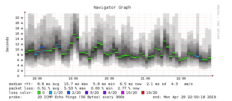

With channel bonding enabled we are seeing drops in traffic, but not in RF. Pings to the other side of the link will consistently time out for 5-7 pings at a time and pick back up. This is on a 40mhz/20mhz split. If we turn of the 20 mhz its just fine.

I have to set up a second PTP to keep production traffic below 170Mbps on the PTP550 or the packet loss and jitter are terrible. This PTP550 replaces RB922 with RF-Elements 27dBi Ultra-Dish antennas. Same channel, same channel width, same power even. Very similar capacity results but latency and jitter at 550 much worse. Maybe something I'm not doing well or my environment does not like the 550 :)
Conclusion (for now) : I wanted to have a hardware with double radio to be able to have 2 channels of 40Mhz and get added capacity and stability. As the bonding does not work, I have the same total capacity and the latency and jitter are worse ... :(
