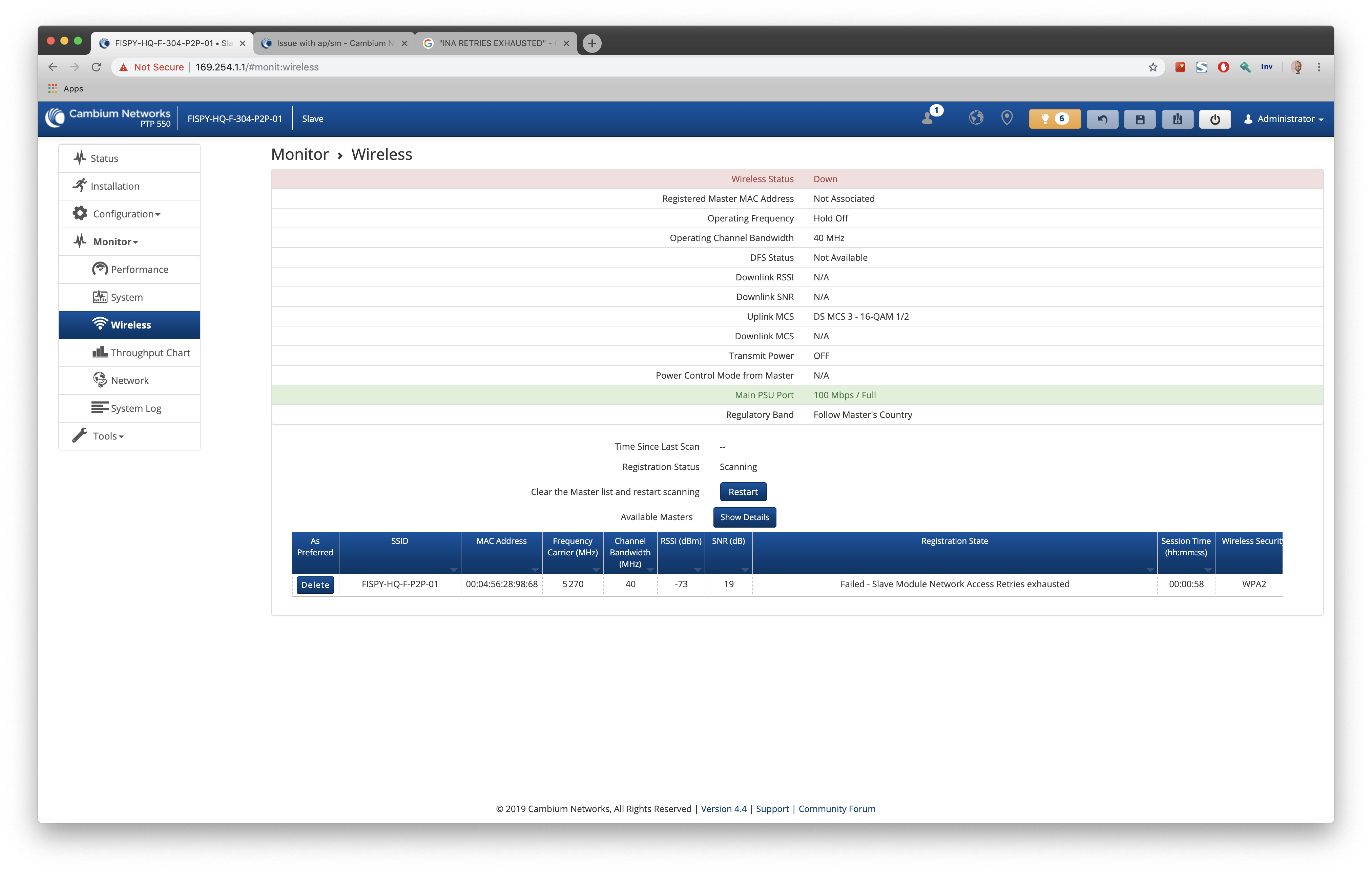

We have a PTP550 link that has been working for over the last 7 months. We move the SM to a different location with the same exact confirguration, and we are getting an error of
SM failed slave module network access retries exhausted
Our RSSI is -72 and SnR sits at 20db. The state of the AP in the SM states that it meets criteria, but again it doesn't establish a link.

This was running on 4.3.21 FW version and we are still having the same issues. Specturm Analyzer doesn't show any high interferance in either side. We tried with Bonding enabled and disabled.
Error on the logs for the SM is:
SM cannot be associated on AP[00:04:56:28:98:68] F=5260 11acvht40plus. Reason: 16 (INA RETRIES EXHAUSTED)
But still we don't see any interferance on either the SM or AP when we run spectrucm analyzer. We tried multiple clean channels and the result is the same. We are upgrading to 4.4 to see if there is any difference.

FISPY-HQ-F-304-P2P-01>show ap
[cambiumSTAConnectedAPTable]
[1]
connectedAPAuthenticationMethod WPA2
connectedAPBSSID 00:04:56:28:98:68
connectedAPBandwidth 40
connectedAPCAPS EP
connectedAPChannel 0
connectedAPFrequency 5270
connectedAPINT 232
connectedAPIsViaInterface 0
connectedAPMeetNEAttemptCriteria Yes
connectedAPNEAge 0000:00:00:25
connectedAPNEState 16
connectedAPNoise -95
connectedAPRSSI -74
connectedAPRate 54M
connectedAPRemainingSTA 120
connectedAPSNR 21
connectedAPSSID FISPY-HQ-F-P2P-01
connectedAPScanAge 0000:00:00:00
