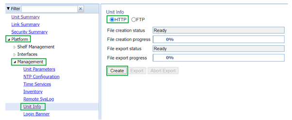

Procedure to download the unit info via web GUI:
Path: Platform>Management>Unit info>HTTP>Create
Refer below screenshot:

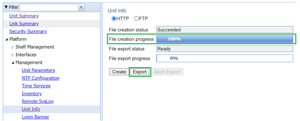

Once we click on create and File creation is succeeded with 100%, click on export.
Once the File Export status is Succeeded with 100%, the file will be automatically downloaded and can be found in the download section of the laptop/machine.

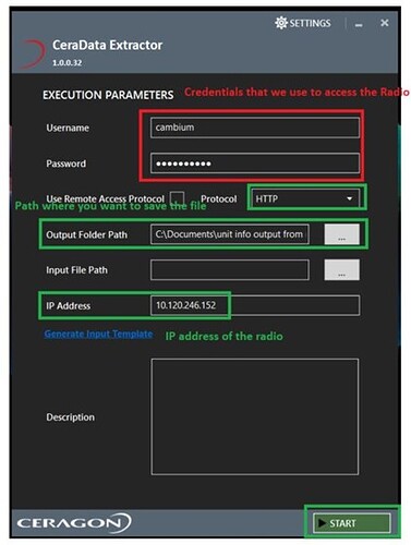

Once the tool is installed and is open, add below parameters:
  • Use the credentials (username and password) that you use to access the radio web GUI.
  • Select the HTTP protocol and locate the path where you want to save the file on your system.
  • Enter the IP address of the Radio and Start.

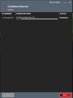

Step 4:
Once we start downloading the unit info, we can see the operation info (creating, transferring) as below:
And once it is complete, we can see the downloaded file in the location that we had defined while setting up the data extractor.
