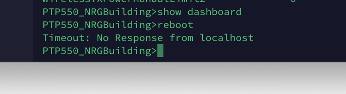

Has anyone seen these errors occur on a PTP550?
Link drops, cannot access web gui, states General error occured. Log in ssh and try reboot and states localhost timeout?
Happening VERY regularily now ....

Only recovery was by removing the power. Can login via SSH but will not reboot by command.

Happened at either end randomily. Needed to power cycle the radio to gain access again and establish link. Confirmed it is an issue with 4.3.1 memory problem. To be rectified in next release. Will see General error occured when trying to login by web gui and cannot reboot by ssh connection. If you have this recommend going back to 4.3.0.1 until issue is resolved or update from cambium regards next release.
