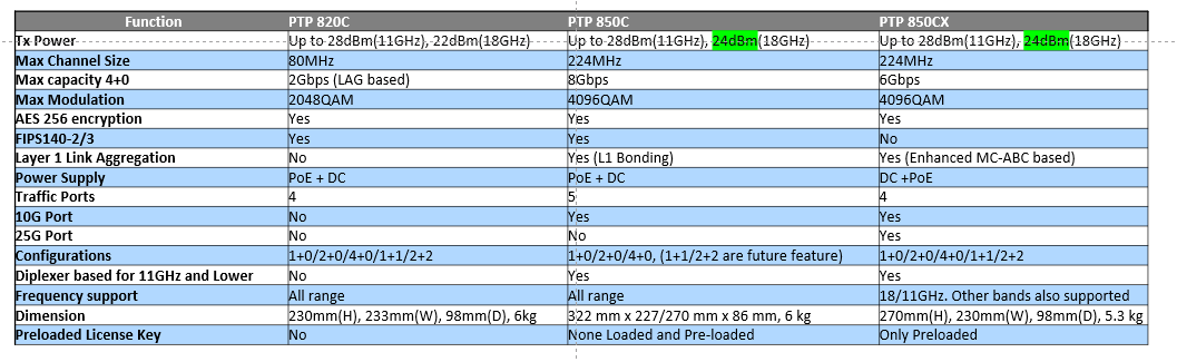

I have browsed the 850cx documentation and did not notice official support for 4+0 XPIC that I have used with the 820C radios. Which newer radios officially support 4+0 XPIC in at least 80 Mhz channels?
Thanks, that table shows the 850C and 850CX support 4+0 and also a bit higher gain in 18GHz when it can be used as highlighted in green. However, currently I understand 4+0 could potentially be setup without or with using XPIC. So, I remain not sure right now. Full support clearly stated for XPIC 4+0 seemed to be something I remember the 820 C documentation clearly stating is supported. I am assuming 4+0 XPIC with at least 80 Mhz channel sizes probably is with the 850C and 850CX, or, that it might unofficially work but is not officially supported in the documentation so I was looking for clarification. This page PTP 850CX Data Sheet - Cambium Networks clearly states both 4+0 and 2+0 XPIC yet seems to potentially omit as if it will not work or is not supported 4+0 XPIC.
PTP 850CX does support 4+0 with XPIC. Even better, it supports layer1 Link bonding in such a situation, allowing single cable to deliver huge capacity.
