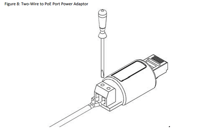

Ideally, on a highspeed point-to-point link, you’ll use DC and Fibre - I do understand that fiber could be too difficult, but if you do, several companies like AFL sell a hybrid fiber option.
If you do use hybrid fiber, you’ll need an adapter for the 850S. It’s called a Two-Wire to PoE Port Power Adaptor.
This is because the 850S does not have a DC Input available out of the box.
Though if you cannot use fiber, please look at a rugged CAT6 alternative with an LPU rated for the PoE voltage and speed - either 2.5Gbps or 10gbps.
