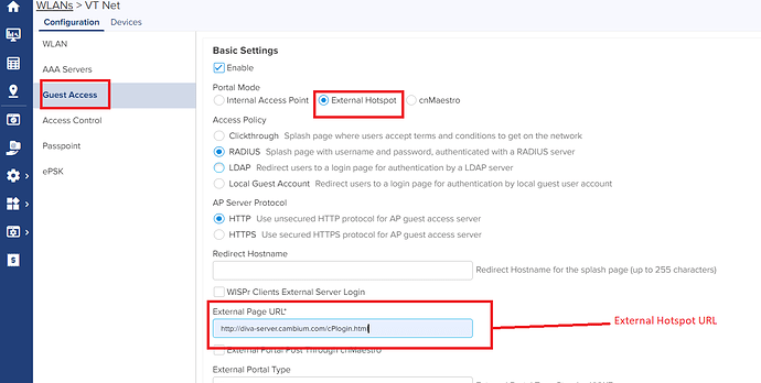

Hi,
For your requirement, please configure portal mode as “WLAN->Guest Access->Portal Mode-> External Hotspot” and the “External Page URL” as your central Hotspot URL. Only requirement is once wireless client/mobile is connected to the wlan, it should have reachabilty to the External Portal, rest redirection part AP will handle. Please refer screenshot attached for configuration.
“ga_srvr” parameter in redirect URL is to inform the client, where the http POST need to be sent, so it will be AP’s private IP address, that should be fine for your requirement to work.
