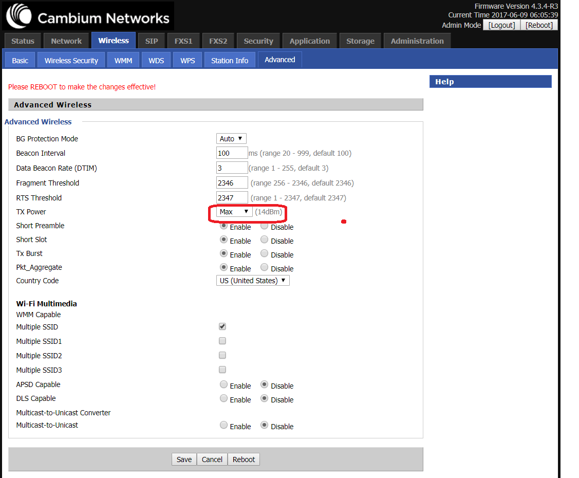

To clarify for everyone, apparently the R200 is actually being discontinued / has been discontinued.
It looks like the R190 has a much reduced wifi transmit power
The R190 on the Wireless > Advanced > Transmit Power setting shows 14dbm for the default Max setting
Max of power of R200 and R190 are 14dBm and Effective Isotropic Radiated Power ( Tx Power + Antenna Gain) of both APs are same.
Please see screen capture both APs
R190_WLAN_MAX_POWERR200_WLAN_MAX_POWER
@nirajlochan, I think the concern was relative to your earlier post where it states dBm for both was 20 dBm, but the GUI shows 14 dBm. Thank you for your clarification, please update the document you referenced previously.
Please see updated table
