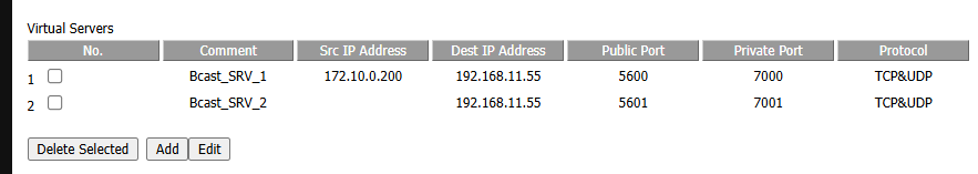

The source IP address field is not mandatory for port-forwarding/Virtual-servers.
In the example below, Rule #1 will be functional only if the connection is initiated from 172.10.0.200; if any other client tries to access port 5600, then it will fail.
Rule #2 would allow access to port 5601 from any client as the source IP address is empty in this rule.
