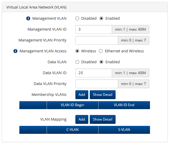

My original quesiton was regarding which dictionary items necessary to provision VLAN configuration through Radius.I am in the middle of my testing but have an irregularity. I think there maybe an issue with 2.6.2 on ePMP with the use of Radius and VLANs. If I log into the subscriber module and goto the section Monitor | Network, I only see the subscriber receiving the Data VLAN and not the MGMT VLAN. My test is on a customer that was provisioned for vlans prior through the web interface. I have attached the configuration section of the radio showing the VLANs manually programmed in. I have also attached what the radio was getting from radius.
Dictionary:
ATTRIBUTE Cambium-ePMP-VLIGVID 21 integer # VLAN Ingress/Data VLAN ID (1-4094)
ATTRIBUTE Cambium-ePMP-VLMGVID 22 integer # VLAN Management VLAN ID (1-4094)
Radius is setup with a MySQL backend and I have verified that both radius attributes are assigned to the username the subscriber module is using to authenticate.
I am afraid to remove the manual vlan settings and have to goto the site to reconfigure the subscriber module.
