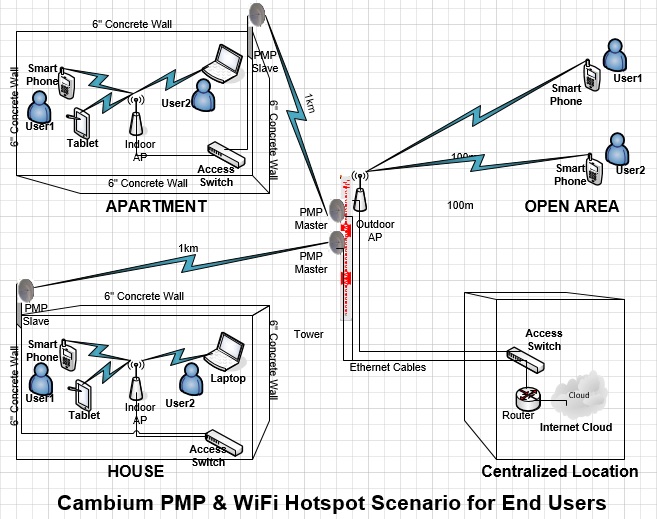

Dear Cambium Members/Seniors,
We want to give WiFi solution over this scenario. Details are mentioned in points.
1- We will establish Centralized Location as seen in diagram.
2- We will installing AP (Access Point) on centre location which is connected with switch/router to provide internet services.
3- We will plan to give WiFi services around 100m of aerial distacne to covered the in-house signal penetration and givee WiFi service inside the home & appartments or open areas.
4- Is any Cambium AP with 9dBi omni antenna covered this distance with 6" wall concrete penetratration to provide best WiFi signals to end user devices or we need to install cluster of 90 degree or 120 degree sectors to provide strong signals inside the houses/appartments?
5- Kindly also suggest other solutions if above equipment/antenna is not suitable according to above mentioned requirements.
Your suggesstion will be helpful here to discuss this scenario.

@KashifKhan83, thank you for providing the attached picture.  It makes it much easier to understand your scenario.
As drawn, it will be very difficult to achieve coverage through the walls of the houses.
Providing indoor wireless coverage requires a two step approach.  You should consider a last-mile access solution such as Cambium's ePMP or PMP product line.  This will achieve reliable coverage from the tower to the apartment or house.  This provides an internet connection to that location.
Cambium PMP solutions
Deploy Cambium's cnPilot Residential or Enterprise WiFi access points inside the house/apartment to provide WiFi conenctivity to the user's smartphones/tablets, etc.
Cambium WiFi solutions
For the open area, you can deploy a cnPilot Enterprise outdoor AP on the tower to proivde WiFi coverage.
Note, all of the above can be managed with Cambium's cnMaestro management which is a free cloud or on-premises solution.
Cambium's network management
Hi Emilio,
Thanks for your detailed response and suggested suitable solution according to the requirement as you showin in diagram.
I'm again modifying the scenario in diagram according to your proposed products line and attached for your reference. Kindly validate and verify, if anything not understand you properly then please reply accordingly.

Hi Emilio,
Furthermore; I'm also written below to understand the scenario as you see in attached diagram.
- Establish Central Site to install tower and make wireless connectivity through PTP/PMP link to provide last mile connectivity to home/apartment and also installing Outdoor AP to provide WiFi connectivity for open areas end users.
- After established PTP/PMP wireless connectivity, then install Indoor AP inside the home/apartment to provide WiFi connectivity with good signal strength for end users handheld devices (smart phones, tablets, laptops etc).
- Each Remote Site needs to install Ethernet Switch to terminate both equipment (PTP/PMP bridge/indoor AP) cables and aslo adding further indoor APs as per requirements.
Hopefully you can understand the scenario after above explanations.
Best Regards,
Kashif Khan,
Cell# +03018273347.
