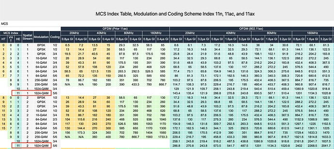

When you use the radio’s built in speed tests, do you get approx. the same results in each direction? When you look at the radio’s Monitor → Performance page, and scroll down to the bottom, what are the majority MCS %’s that packets are being sent at?
Having one side of the link always has SS MCS rates can indicate that one of the two chains on the radio is having issues.

So to answer Eric; when using the radio’s built in speed tests, I get (for a 20 MHz link) 119/58 Mbps. This is on a 50/50 TDD link with co-location disabled.
On this particular radio, 92,5% of downlink packets are DS MCS 11, and 97,4% is SS MCS 11 for uplink packets.
Additionally for uplink, there is 2,4% SS MCS 10 - and actually there is a 0,2% DS MCS 6. For downlink there is 7% DS MCS 10 and 0,2% and 0,3% of DS MCS 9 and DS MCS 8. This link is only 2400 meters.
The other problematic link is quite a bit longer, 11 000 meters (but I also have one at 12 000 meters that performs flawlessly, both uplink and downlink have about 90% DS MCS 11)
This other problematic link has about 85% SS MCS 11 for downlink, but the uplink is DS MCS 9, 10 and 11. So this is opposite of the first link mentioned. For this link I even tried replacing all of the hardware at the SM end (radio, antenna and twistport adapter), but that made no difference. I have not tried swapping out at the tower yet, but will try if you think it’s worthwhile.
