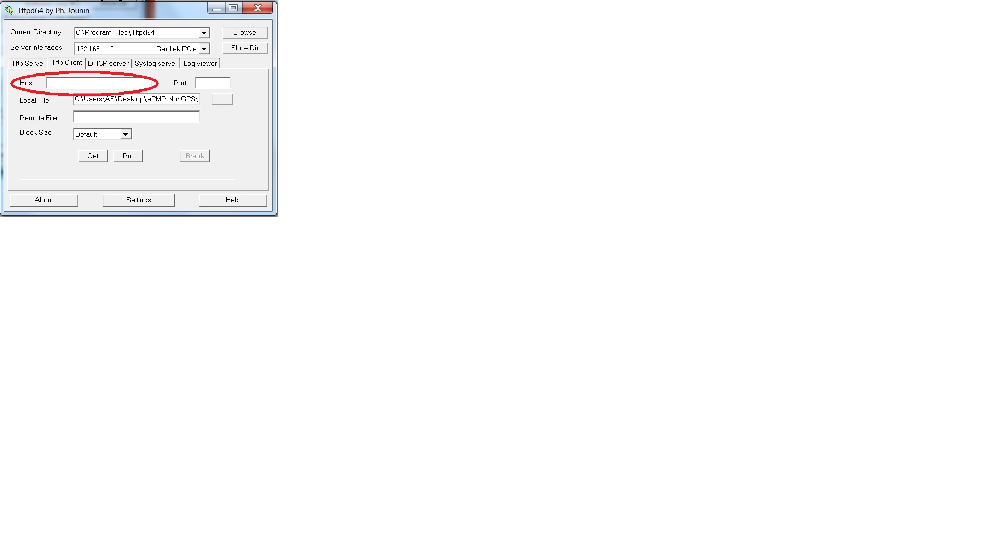

HI
what about host ?
what i will write
Hi @samer_jouda,
you are showing tftp client page. But you have to set up tftp server with address 192.168.1.10 having firmware.bin file.
change your settings to tftp server, your computer must be set to manual ip address 192.168.1.10 with a subnet mask of 24 (255.255.255.0) and no gateway.
make sure your windows firewalls are off for this or it wont work

use a windows computer with all firewalls turned off.
set your ethernet port address manually to 192.168.0.10 255.255.255.0
use tftpd in tftp server mode.
set the tftp folder at the top to the folder with your recovery firmware (this is as described in the recovery procedure document)
connect the power brick lan port to your computer through a dumb l2 switch (netgear 504 is good) then connect the radio to the power brick. as it powers on it will search for the recovery firmware.
Note:
windows networking is way to slow to have a direct connection without a dumb switch between to keep the port active. This is a must or the radio will not find the firmware and halt before windows brings up the port for data passing.
