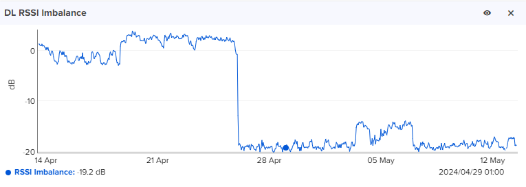

We recently changed the frequency on our 3.65 450Ms to utilize our PALs, but oddly we are seeing some of the SMs now have more of an RSSI imbalance according to cnMaestro graphs. Any thoughts on why this might occur from a frequency change?

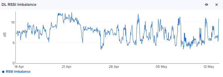

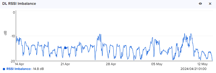

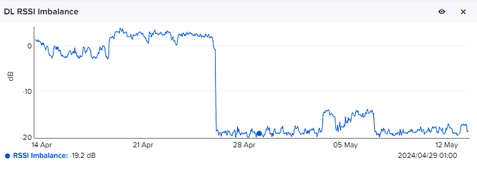

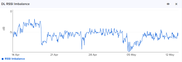

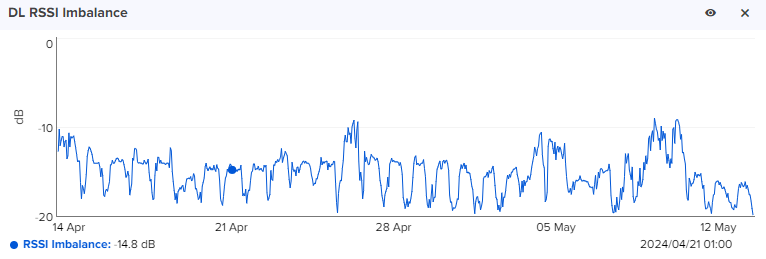

Most of them only show a few points, maybe 2-4dB, but there are a few SMs with a MASSIVE difference, like 10-20dB or so. Attached a few screenshots of the major offenders. None of these customers are reporting any issues, I was just curious as to what typically causes this, especially when the RSSI numbers are good in general. Some of these have been like this for a while, but others only show the large imbalance after a frequency change.
