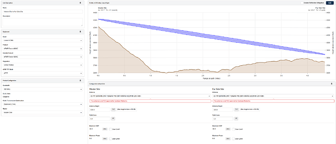

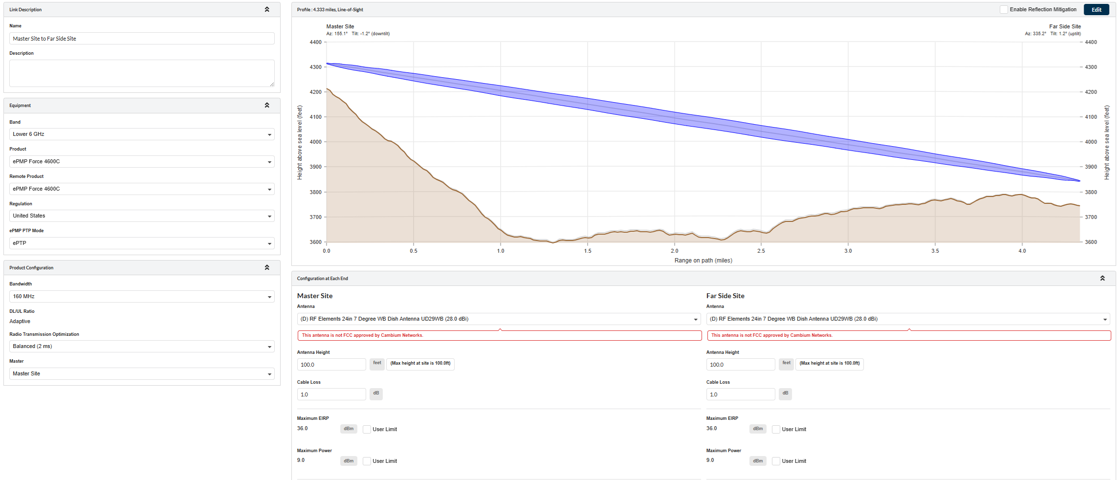

Thanks! I know it’s impossible to make a true prediction, but if you were to make a rough guess, what do you think would be an expected throughput for a 7km link, 20MHz of UNII-1 + 160MHz of UNII-5, between a 30dB and a 34dB H/V dish? Currently, it states 11x modulation on the UNII-1 and 5x on the UNII-5.

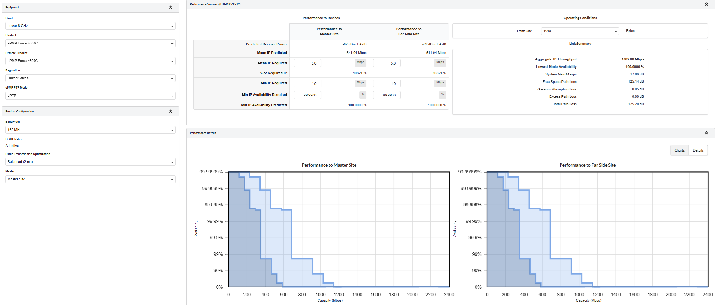

https://lp.cambiumnetworks.com is a good tool to use to estimate link capacity.

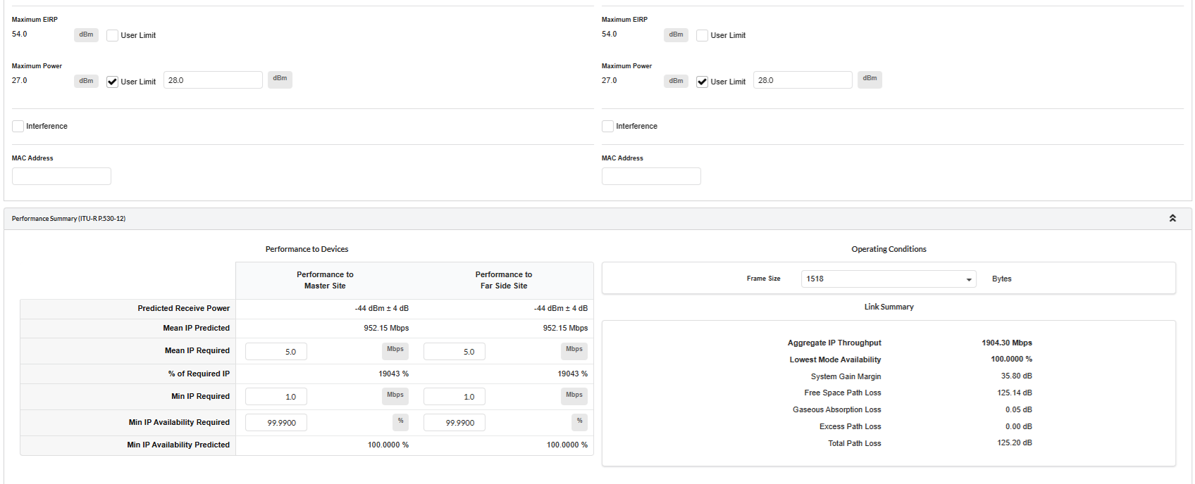

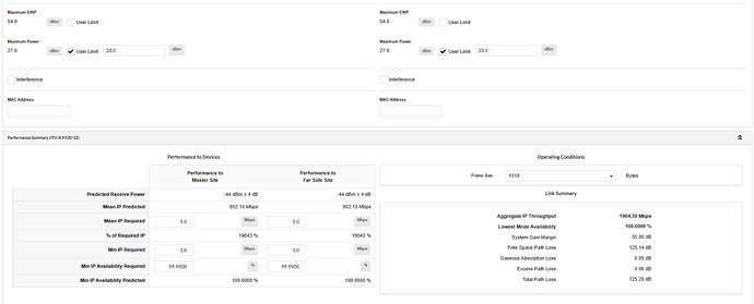

I assume you’re located in the USA hence why you’re asking about the 6GHz/AFC? When I plug in a 7km/4.3mi LOS path into LinkPlanner Online, using the F4600c + 2’ dishes, and 160MHz channel, I get 541mbps in either direction, or 1082mbps aggregate. Due to EIRP limitations with the 6GHz/AFC band, the figures that I’m showing in LinkPlanner seem more realistic with field experiences we’ve had.
If you’re in a region that allows for higher EIRP and can use the maximum TX power of 27dBm, you’d get almost 1gbps in either direction, or 2gbps aggregate.
