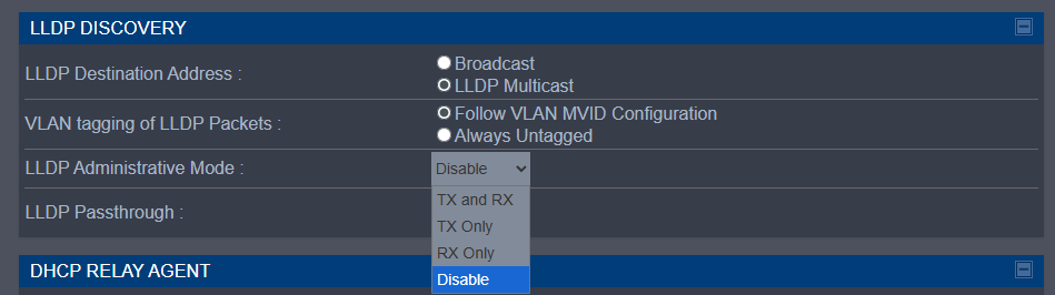

I think you can probably ignore that error as it most likely has something to do with LLDP (assuming you’re not using LLDP). You can also turn off LLDP on radios by using this setting under Configuration → General:
