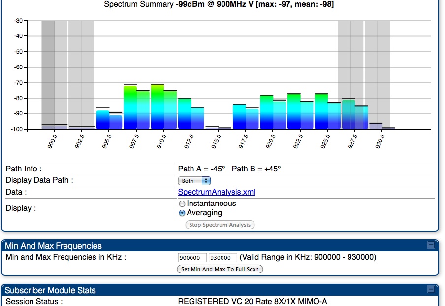

What kind of signal are these subs at? Assuming you already verified the basics like doing spectrum scan making sure not a ton of burst noise at customer location from another 900mhz device

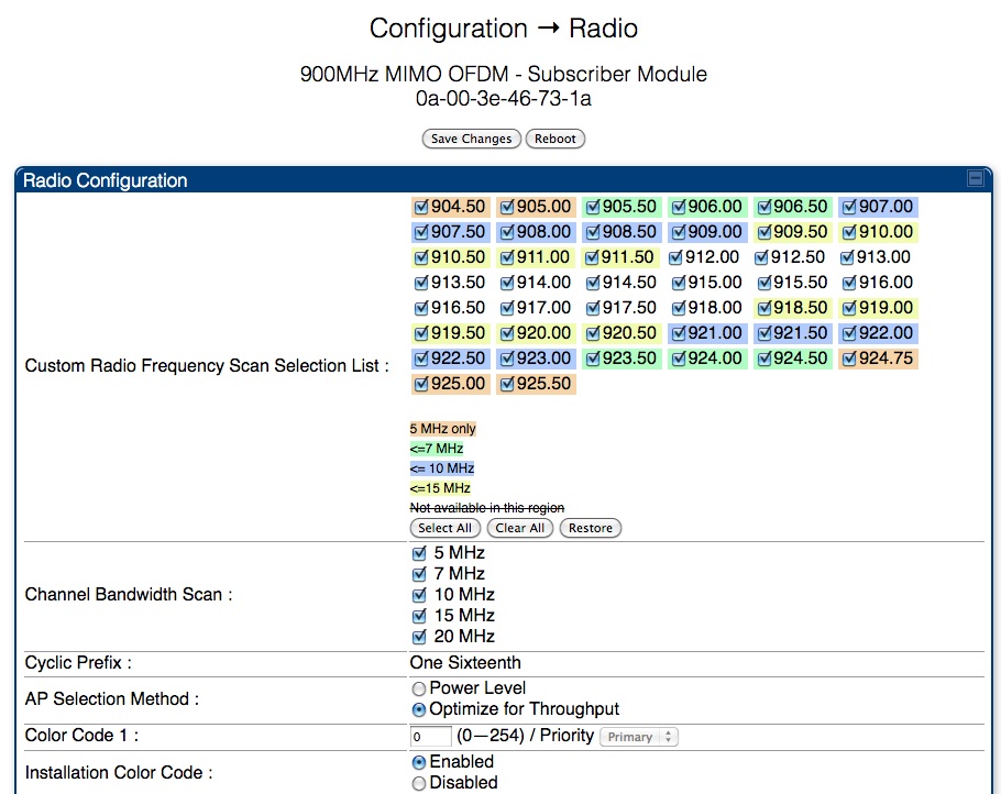

All the color codes are selected, should there be a narrower band?
Here is the Spectrum Analysis
We are using  Color codes, all of them! You said "use a smaller channel size", is this related to the spectrum analysis?
The channel settings are on the access point side and set under the radio tab.

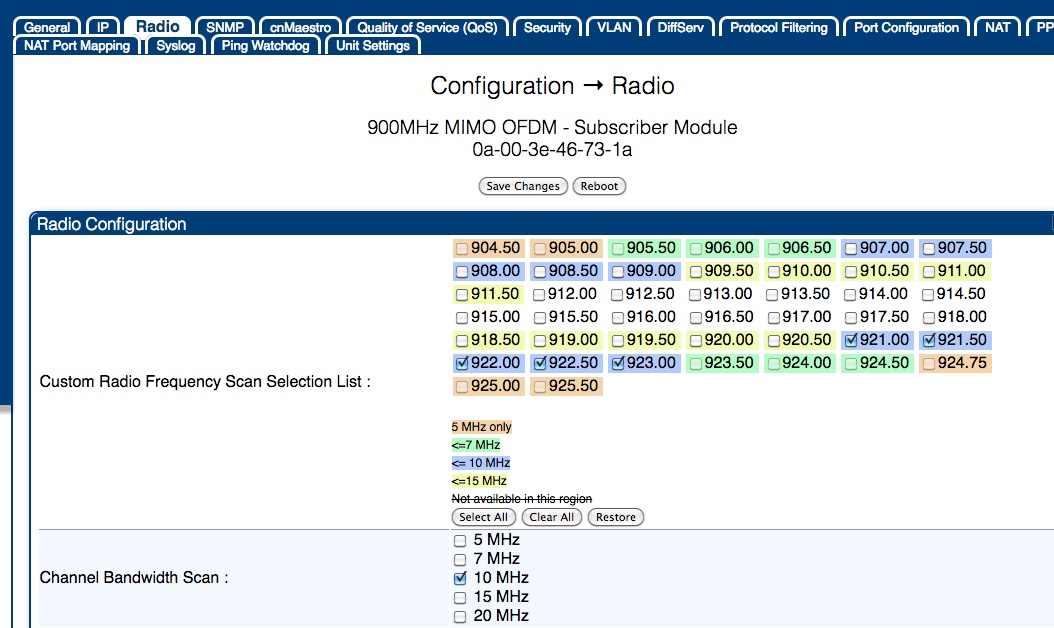

Narrowing the radio scan selection list, as well as the channel bandwidth scan fixed the problem of the Internet connection (PPPoE) dropping.  The session still re-starts every 10 to 15 minutes, but this does not affect our internet connection.
The Channel Frequency and Channel Bandwidth selections were based on the info on the Home"page's "General Status" under "Subscriber Module Stats"

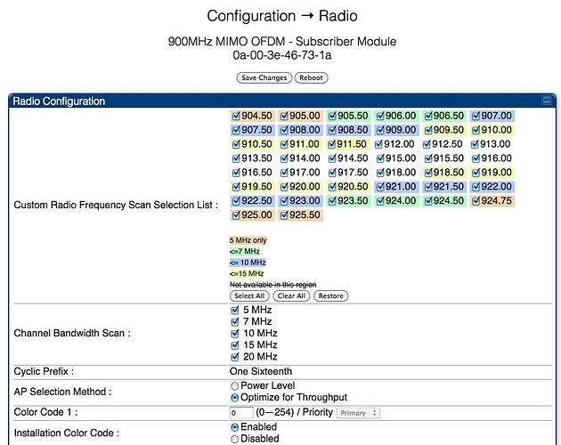

You can see on the above graphic that the Session has recently restarted, but the PPPoE Session persisted.
