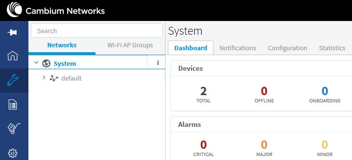

I decided to delete both AP on Network an Claim them again. Now they are Onboard, but I can't see/manage them under Wi-Fi AP Groups. Can you help me?
- Capturar2.JPG (21.4 KB)
- Capturar3.JPG (38.1 KB)
- Capturar4.JPG (46.5 KB)
- Capturar5.JPG (42 KB)

now aps are online, reviewed mesh base and client wlan profile and ap group file, do not find any issue. configuration is psuhed now, aps online from last 7 minutes
E410-ALMIR is now part of MESH Base and
E410-ALMIR2 is now part of Mesh Client
Thank you so much. But before I mess it up I could see both under Default Enterprise also. Why can't I see them now? Is is possible to see them there?
let me explain how aps are managed in cnMaestro. there 2 ways we can manage aps,
method#1 manage aps under sites, sites are grouped under network
Network --- Site -- Wi-Fi APs, it can be like
building x -> floor 1 --> Group of APs
method 1 is like APs grouped based on deployment location, since you not created any site and network APs under default network called default. You can try creating Network say New York and Site called Subway Shop and moves APs under site.
method# 2 manage aps based on ap group
in your case one 1 ap group with the name Mesh Base and other AP with the group Mesh client
so you see 2 different aps under 2 different groups
earlier, when APs on boarded to controller you puhsed default ap group, which doesn't have MESH connection, that is why you lost both the aps from the cnMaestro
method#2 is grouping aps based on configuration
now we pushed right ap group so that you can see them online
hope explanation is clear
