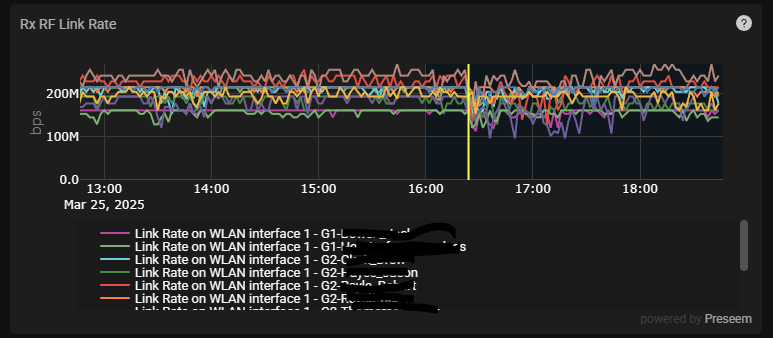

Anyway the bigger issue is that this SM caused the UL rates of the SMs on the opposite AP (South AP) to become unstable. Some worse than others. What is odd is that some clients with better signals at the South AP are affected more than clients with worse signals at the AP.

I had to turn down this particular SM to a TX power of 0 which gave it a -64db signal at the AP to lessen the effects, but the South AP SMs TX rates are still lower than before this client came online. What is odd is that other clients on the North AP with -60db signals to the North AP did not seem to cause any issues with the South AP clients. It was not until I brought this close SM online. I even have another SM on the norht AP at .33 miles and it does not cause any issues for the South SMs.

These are the South AP SM TX rates to the AP. Yellow line represents when the new client on the North AP came online.
