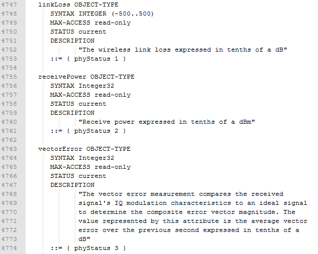

You could usefully retrive Link Loss and Vector Error if you're working on a management application. The MIB file is in the software package on our Support web site.
Also, we have the MIB in a text form. That's a bit harder to navigate. For example, here's the information on Receive Power:
