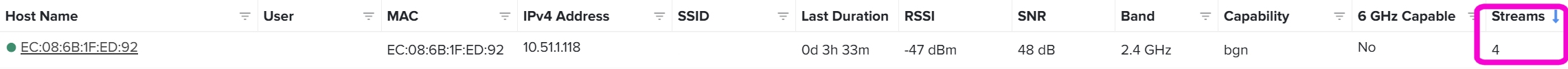

@rajesh_v These are fairly old wireless adapters, I seriously doubt they are capable of 4 streams. But, that’s what cnMaestro is showing for them. Maybe this will help determine why they can’t connect to the X735X.

4 streams issues query - Please confirm if devices are upgraded to 7.1.1 Beta version. This is addressed as part of 7.1.1 release. Reference Jira: FLCN-18092 (Spatial Streams for ‘an/bgn’ client is updated to 4 instead of actual stream number)
