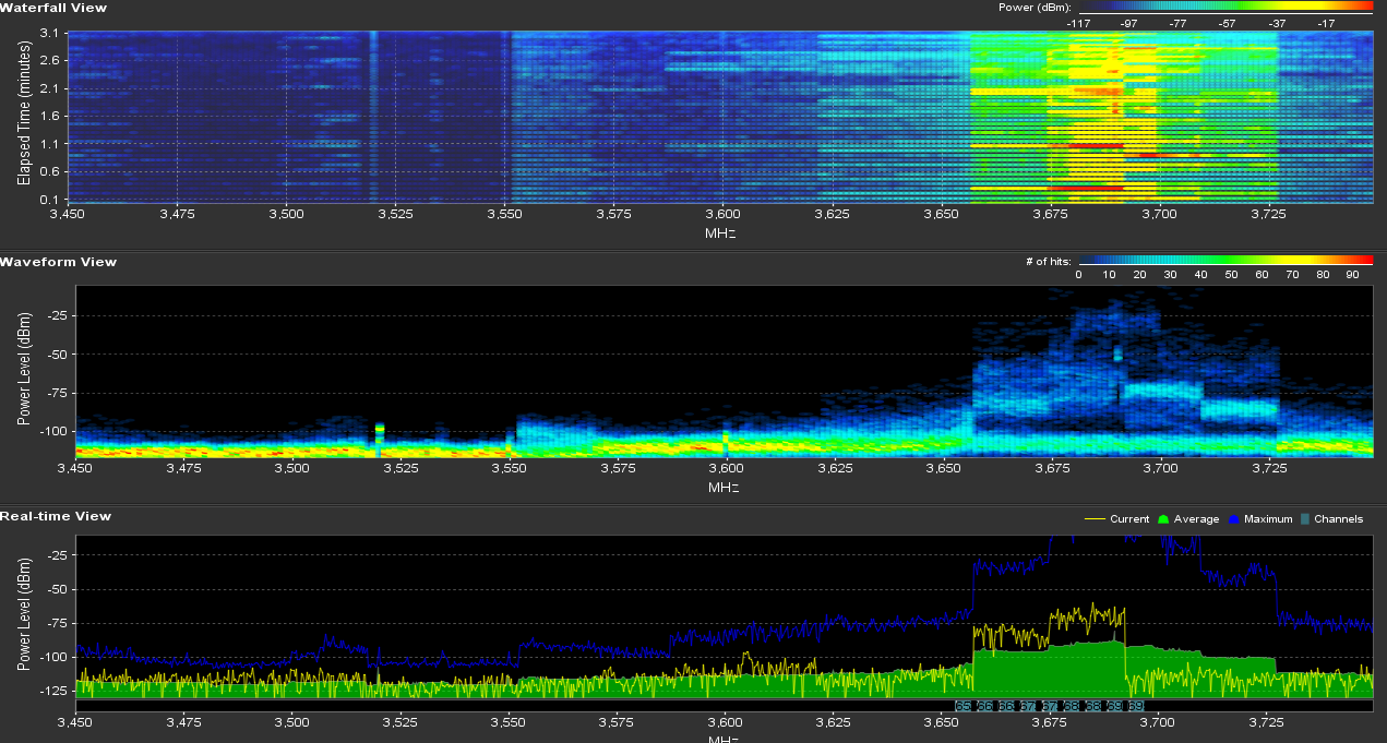

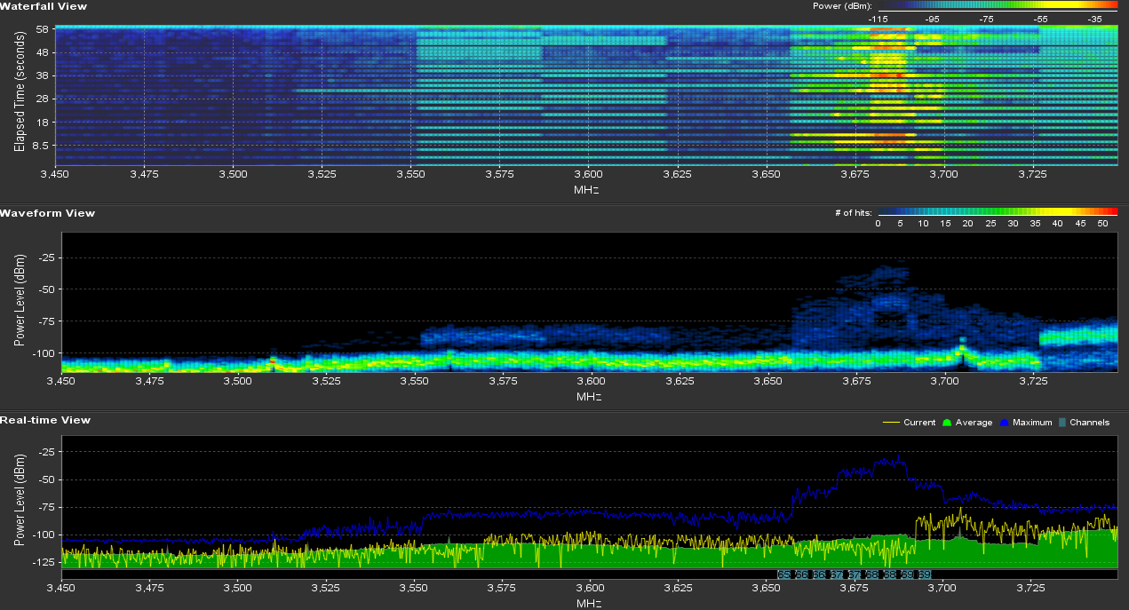

We're currently deploying a lot of Baicell LTE stuff (much to my dismay).  What I am the most upset about is the amount of bleed into neighboring frequencies.  I used a spectrum analyzer on the Baicell we have, and then another on the Cambium 3.65 that we have in a different location.  Holy crap.  The LTE looks like it bleeds heavily into about 20mhz on both sides of the 20mhz channel.  The 450, on the other hand, is much cleaner.
Has anyone else done some comparing to see how these differ?
These are a little different situations, because atc is a guy-wire tower with three 120deg KP Performance sectors running 10mhz channels, and the elevator is a single Baicell AP with a 90deg KP Performance sector.
The scans were done with unused Ubiquiti APs that are waiting to be removed.  The atc has Ubiquiti APs within 3 feet of the Cambium sectors, and the elevator has a Ubiquiti AP within 20 ft of the Baicell AP.

The way airview works can cause those 20mhz-wide chunks of seemingly noise.
That may or may not be there, will depend on the relationship between the actual center frequency the LTE stuff is in, the actual center frequencies the airview driver is programmed to hop arround, the channel size of the RF source(in relation to the channel size airview is listening in), the  time relation between the presence of energy and the scanning cycle of the airview device.
Overall, airview is a good tool to tell you if there is stuff talking in the band, and in which frequencies the stuff is talking in(and therefore the stuff-free chunks of spectrum, if there are any).
You can educatelly guess about the actual magnitudes of the signals being amostrated, but without an 802.11 frame(or preamble) to calibrate against, the power levels you're seeing are an estimate by the airview algorithm.
 If you need a measure of how dirty a signal really is, and how much it bleeds out of the intended channels, you should take a look at the FCC certification plots for that device.
