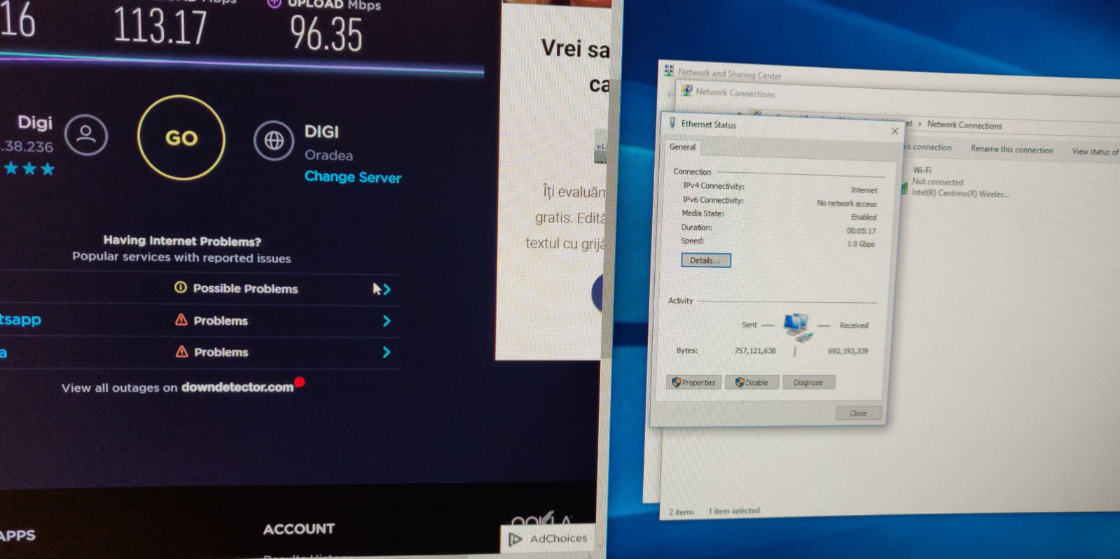

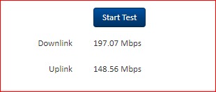

I have a question: in the Internet speed test the maximum speed reached in the router is 257 Mbts down and 97 Mbts up. Over the radio link speed is 113 Mbts down and 97 Mbts up. With Epmp  wireless link test the speed is 198 Mbts down and 144 Mbts up.
Can somebody explain me why is this diference? From my point of view the radiolink is in perfect conditions...

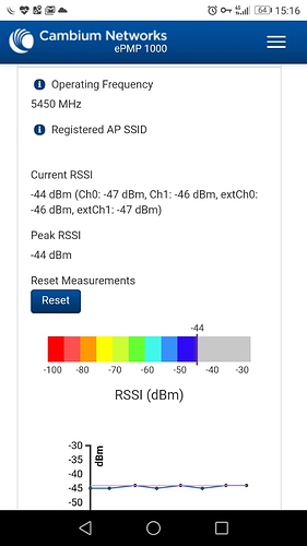

This might be because speedtest.net and the app use a single stream of TCP usually over port 80... whereas the radio's speed test uses UDP. UDP by it's nature will result in much faster reported speeds. For most accurate results, try to use a Mikrotik to Mikrotik or iPerf to iPerf test using multiple UDP or TCP streams.
For now it’s ok with that speed…but I was curios to find out why is this difference between the tests.
Eric is correct and the RF link test is done using UDP traffic, which typically shows better performance than TCP based tests.  Regarding the topic of speed tests, and the difference between radio connected rates and third party server (i.e. speedtest.net), please see this post for some additional information.  There may be other factors in play influencing the results, end to end.
Without any modification on windows, this is speedtest direct from Provider FTTH Gpon:
speedtest from Provider FFTH
