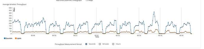

Strange behaviour on 5.10.1 with hardware acceleration
Bug? when enable hardware accelaration i

Hi Andrii, Thank you for your reply. After disabling hardware accelaration, its work fine. Before that, I had many troubleshoots I made. It takes 2 days before I see the problem.

Were you seeing any functional issues with throughput actually dropping like that or was it only showing up on the graphs like that? i.e. did customers see drops from this as well?

Are you sure it is not a packet loss on wireless? Like capacity drops or so…
Every 50 sec drop can be like OSPF session?
