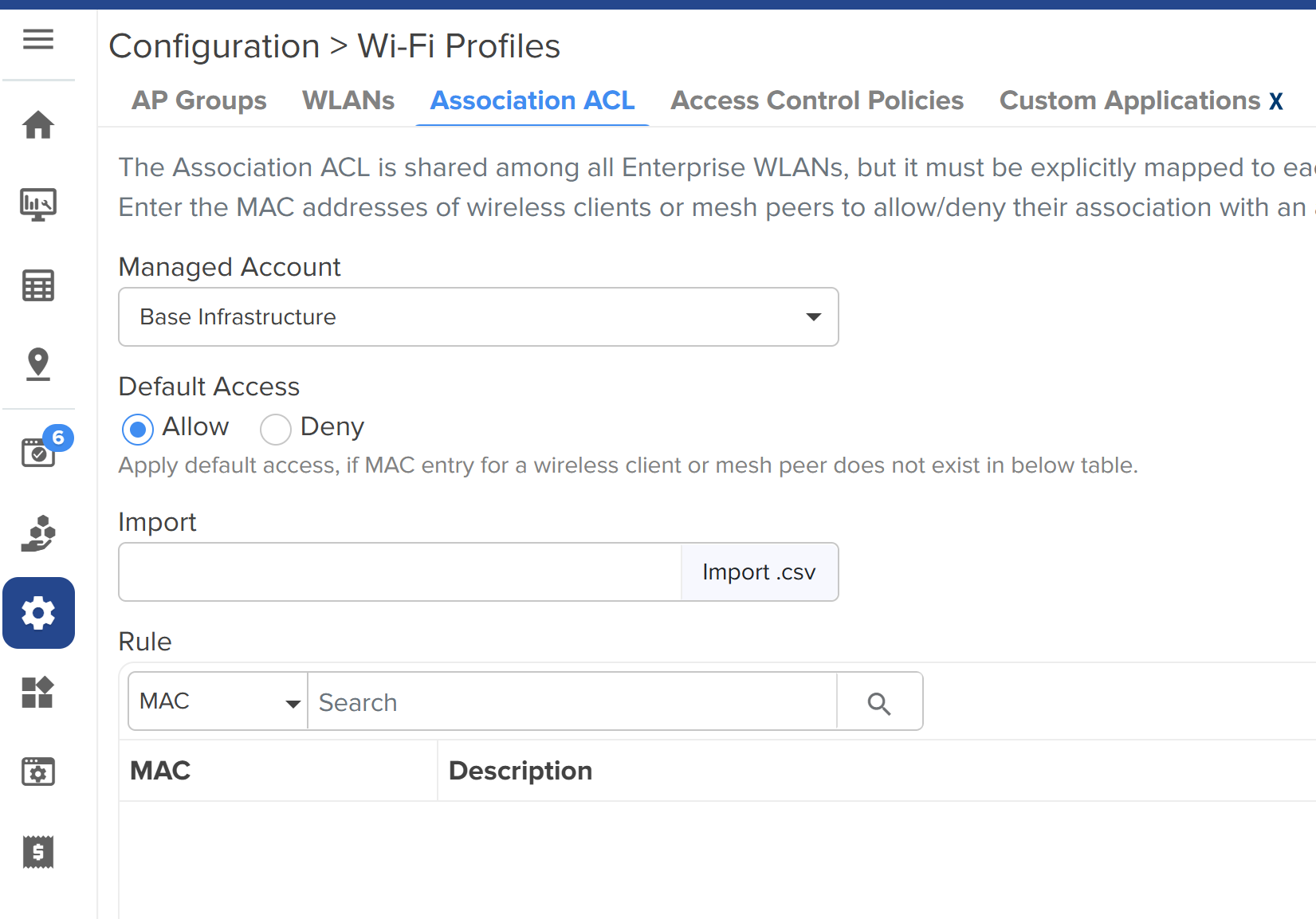

1. Association ACL method:
We added MAC addresses under Association ACL and also under WLANs > Access Control > MAC Authentication > cnMaestro.
However, this method is not fulfilling the requirement, as clients are still able to associate even when the MAC address is marked as blocked in the Association ACL.

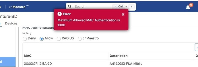

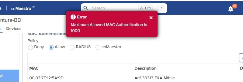

2. MAC Authentication (Allow list) method:
We added MAC addresses under WLANs > Access Control > MAC Authentication > Allow.
This method is working correctly and fully meets the customer’s requirement.
The challenge with method 2 is that the maximum supported limit is 1,000 MAC entries,
We requires 6,500 MAC entries.
Could you please advise how we can implement MAC Authentication (method 2) for 6,500 MAC addresses?

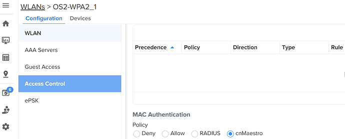

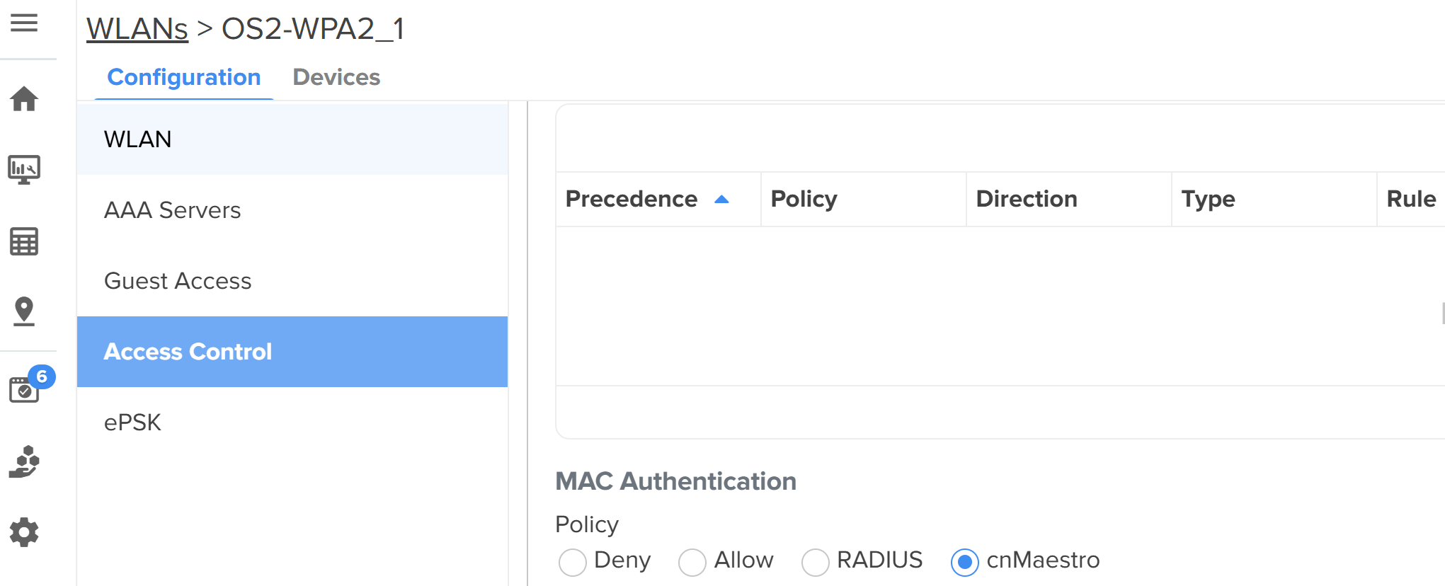

Please confirm if allowed MAC address are same across all APs.
If yes, please use cnMaestro based ACL.
MAC addresses are the same across all APs. but for a different SSID
Hope MACs are unique per SSID.
  • SSID 1
    • MAC 1
    • MAC 2
  • SSID 2
    • MAC 3
    • MAC 4
      If yes, you can use cnMaestro based ACL.
