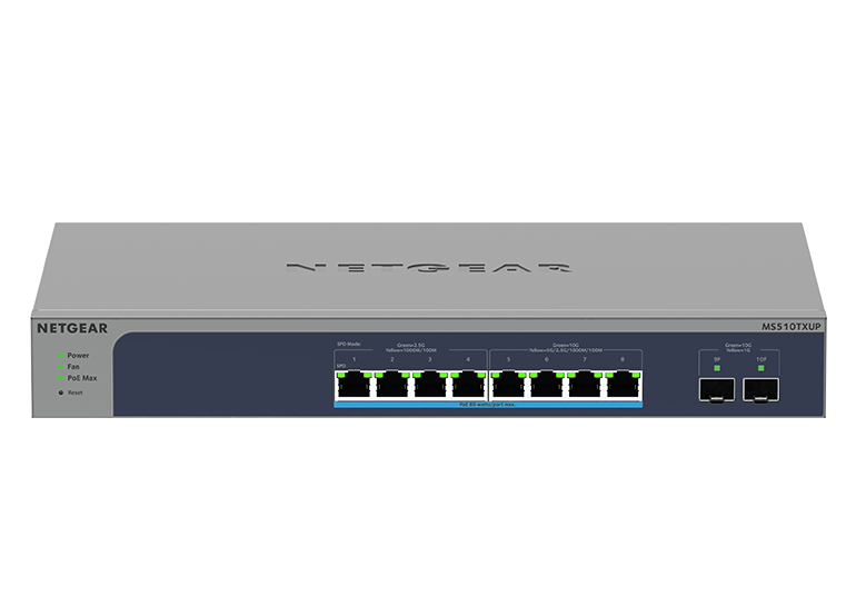

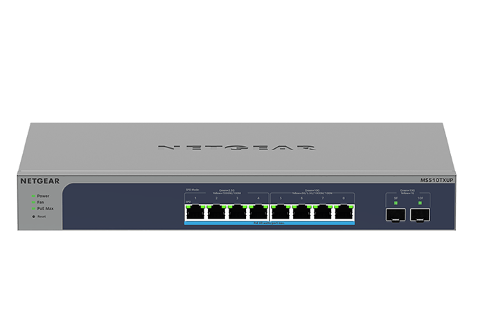

Netgear work perfectly :+1:
This one?
Fo example. This one I had pleasure to test and it work perfectly with cambium staff.

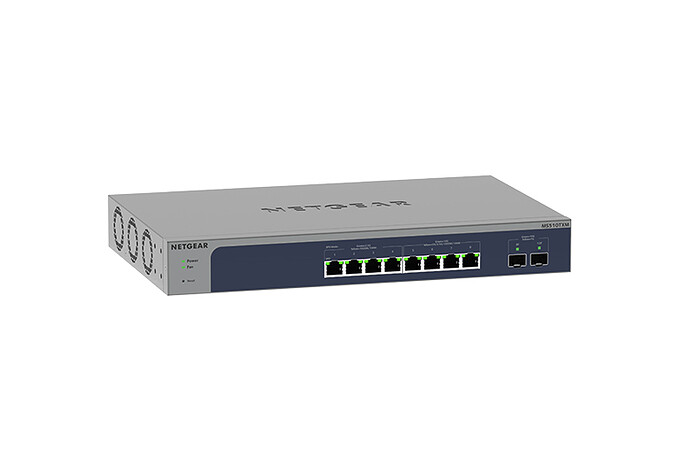

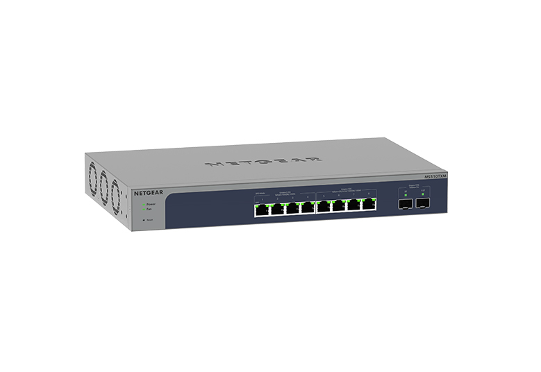

just following up on this, is there a switch that will utilize the 5Gbps connection on the new XE5-8?
Just got this one up and running this morning.
