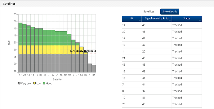

So based on my pic this is working fine? On all my sectors that look like the above picture seem to perform worse where others that look like this…
They Perform better… maybe just coincidence? I had posted once before with a similar pic that showed very little yellow and mostly gray for SNR and others had said that it didnt seem right and should be concerned. I am a bit discouraged… this tower is very rural, we are the only WISP in the area and just cant seem to perform well. I really appreciate your help!
This graph basically shows Signal from each of the Satellites – so yes, with all that green, your GPS signals are fine on this AP. You may potentially have some other different GPS issue, but your signals on this AP are fine.
As others have said - GPS syncing is either locked, or it isn’t. Now, just to be clear, it is possible for an AP with low low signals to be locked, and then later to unlock when signals degrade, or when GPS interference get’s worse… But at any given moment, it’s either locked or not. That is the “binary” part that people are talking about. If an AP is Tracking 16 Satellites in the Green… or if it’s tracking 5 Satellites barely in the Yellow… the point is: if it’s tracking and locked, then it’s tracking and locked - and GPS will work the same either way.
SO - if GPS isn’t unsyncing (ie: if you’re not getting alerts that the GSP is going down) then GPS isn’t your performance issue. It doesn’t matter if you have 12 Sats in the green, or 4 in the yellow… if it’s enough to lock and to stay locked, then that GPS will work just as well as 12 or 14 green.

Thank you for your continued insight!! I will try and figure out if there is self interference… not sure where to start with that lol.
Here is the AP SA
