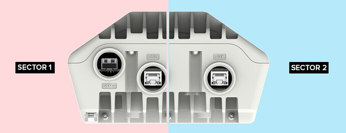

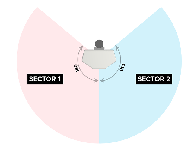

Please also ensure the right sector is connected to the V2000:
Once you in the field it’s important that the installer points the front of the DN in the direction planned in those tools, this ensures the sites are aligned to the plans you have made.
But you are correct the SPF+ is on the Sector 1 side, I suspect for lab work this is a good aid to remember, thank you!

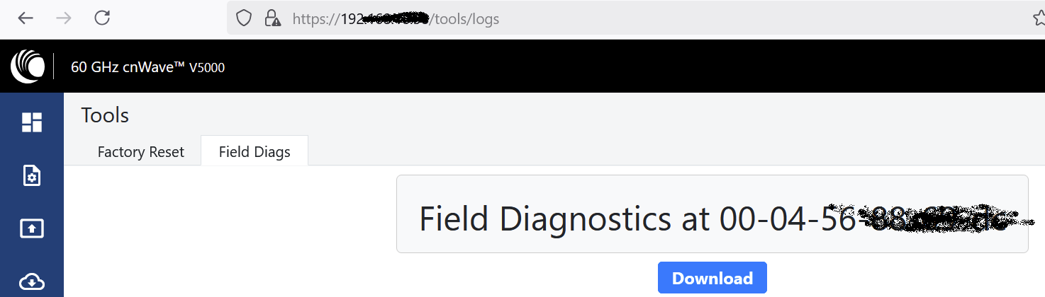

Hi De Vaughn elledge, for me to share more comments/rootcause, i would need your help to get me field diags of both your V5000 and V2000.
snippet to assist you to find/download field diags

How did it go, most of the time when people try it in doors they put the V5000 upside down and that will cause confusion with the sectors.
Then we get reflection etc which can connect sometimes. This devices are high power so can bounce around a room.
