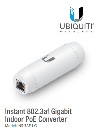

The solution is to use a PoE converter, such as
This converter tells the switch the port needs to be 802.11af, and the output of the converter is passive 24v.
