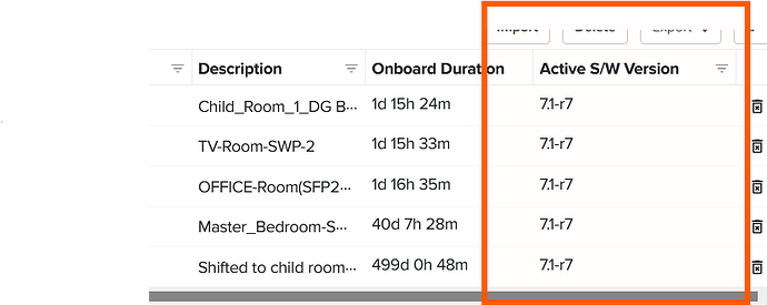

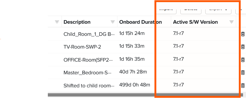

Current Firmware
Most APs:
- 6.6.2-r4
One AP:
- 6.5-b6 (not affected by this issue so far)
