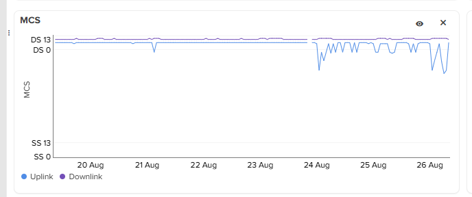

Today I noticed that since that AP reboot 6 of the 9 SMs experienced worse UL stability than before the AP reboot. I have the SMs scheduled to reboot tonight but I have rebooted a couple of them and like I have seen on other APs the SM reboot fixes the rate problem.

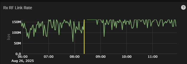

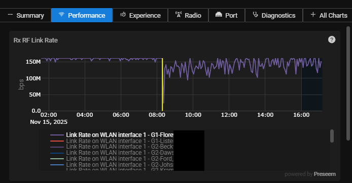

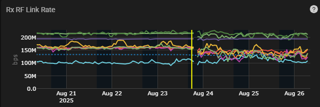

This is an overview of all SMs TX rates (chart is from AP perspective that is why is says RX rates). Yellow line shows AP reboot.

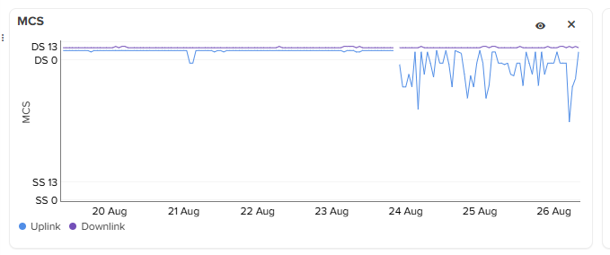

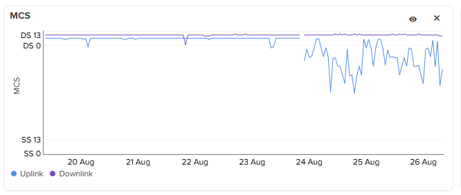

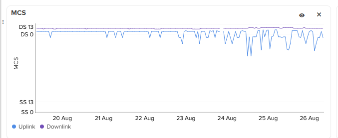

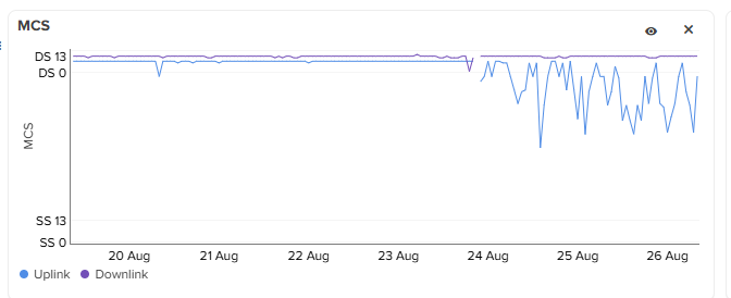

Here are individual SMs charts from cnMaestro.
I was at first thinking AP side interference but I checked and there is no new noise. I then remembered that I rebooted the AP on the 24th at the exact time the rates became worse.

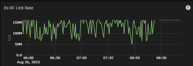

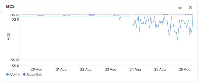

Here is one of the SMs after I rebooted it. As you can see the SM reboot fixed the issue.

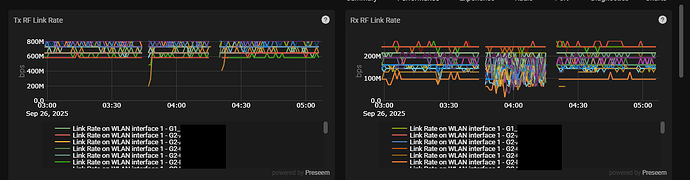

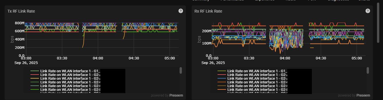

Here is a photo of the SM rates from the AP perspective. The first gap in the charts is the change from Beamforming only to MU-MIMO on the AP. The second gap is the mass reboot of all the SMs. Pretty easy to see the bad UL rates.

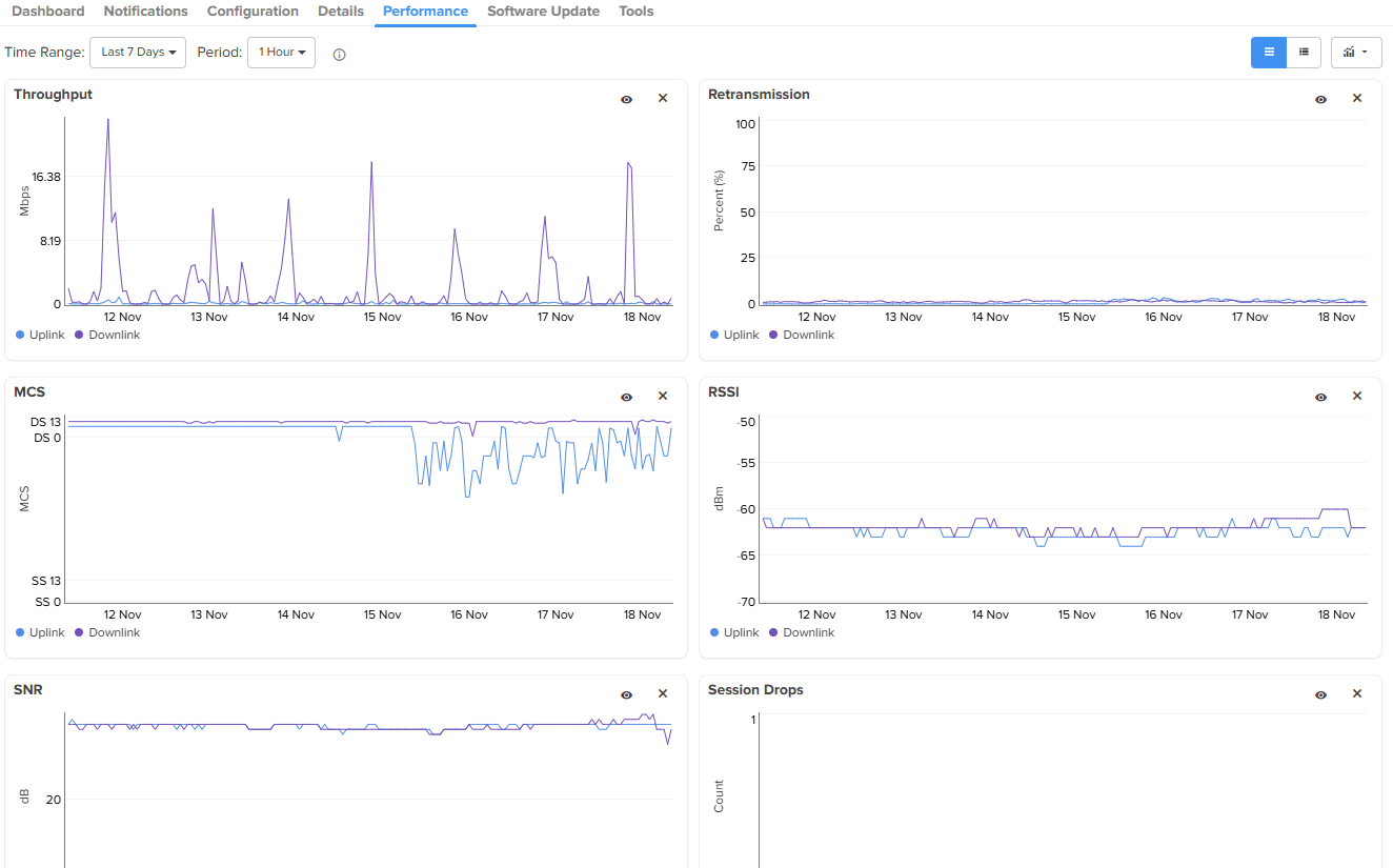

Here is a shot from cnMaestro of one of the SMs showing the only change was the UL TX MCS rates. Signal and SNR are pretty much the same.

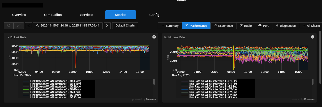

This issue with the uplink rates crashing, which in our case causes poor overall speeds along with extreme bouts of latency/jitter across the AP, can be temporarily resolved by rebooting the AP. The issue seems to be amplified with intermittent noise, larger channel widths, and backwards compatibility mode. We have a site with 4x 4500 integrated 8x8’s using 80MHz channel widths, and backwards compatibility mode and this issue would usually happen every day, forcing us to reboot the AP’s.

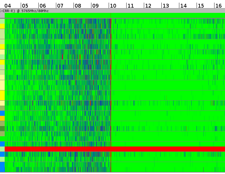

You can see a visual representation of the latency/jitter here. Blue is high latency/jitter, while green is low latency/jitter with everything working fine. The red line down the middle is when the AP was rebooted.

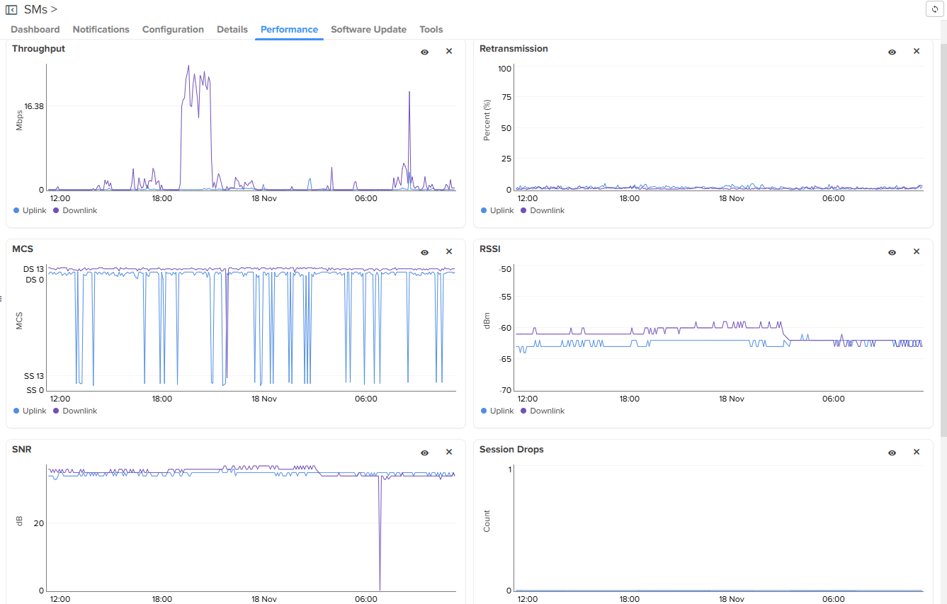

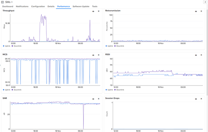

Here is what I am seeing on the SMs. The UL MCS for this example client seems to jump around often between DS7 and SS7 where before it was a mostly stable DS7.
