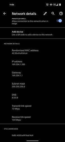

From Android 10 and above the cnArcher cannot override the IP configuration of the phone. As a workaround the below steps can be followed:
Step 1: Connect the phone to the AP WiFi.
Step 2: Select “cnArcher is not managing the WiFi.”
Step 3: Manually configure the IP address of the phone to 169.254.1.x/24 . ex 169.254.1.10/24.
Settings>>Wifi>> SSID>configure>>advanced>>IP address>>static. (this can vary from vendor to vendor but path remains same.)
Step4: Open the app again and it should be able to communicate with the SM via the wifi AP.
The SM should be detected by the cnArcher and ready to be configured.
