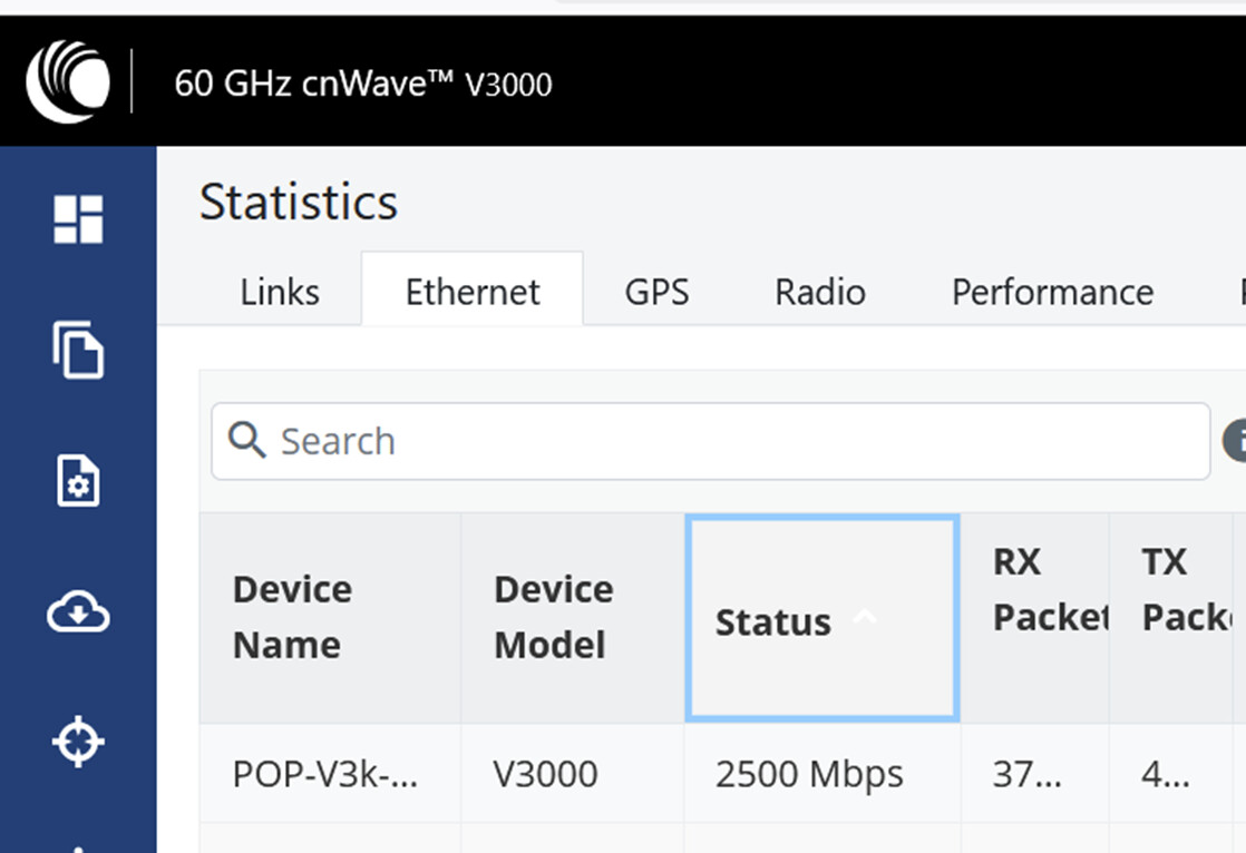

Hi All, I’m planning a wireless PtP link. We’re looking at the V5000 and V3000 that both support 100/1000/10G PoE. The switch ports that we’ll be connecting to only support 2.5G. Will there be an issue between the port speeds? From experience, if it’s not stated then it’s not supported.

Q: The switch ports that we’ll be connecting to only support 2.5G. Will there be an issue between the port speeds?
A: No. There will not be an issue.
The main ports on the V3000 and V5000 are capable of supporting a 2.5G uplink speed. The exhibit below, taken from a lab setup, shows the negotiated link speed as 2500 Mbps in the Status column.
