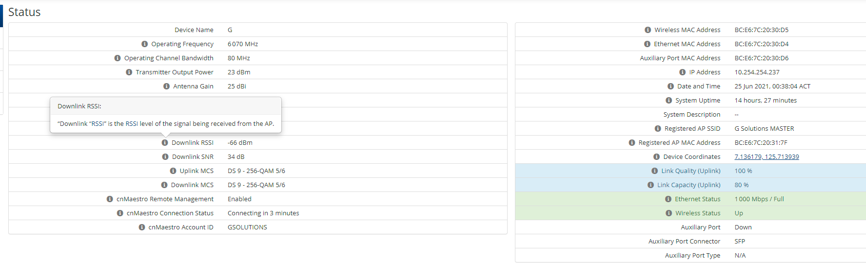

Thatâs about right for DS9 Modulations (256 QAM).
If you can get the Modulations to DS10/DS11 (1024 QAM) will speed things up even more.
My personal recommendation for those who need bandwidth above 500mbps at 5ghz is to have a noise floor of at least -90 on the channel to be used.
If not, give up.
Use another frequency.
NOT WASTED AT ALL. LOVING THE 425 NOW.
